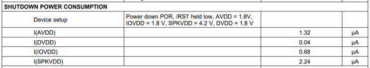

I would like to confirm power consumption in shutdown when LDO selected.
The shutdown current in datasheet can be applied shutdown current in LDO usage case?

Hi, Matsunaga-san,
These values apply for individual supplies on each pin and no internal LDO being used.
If the LDO is always active with LDO_SEL pin, the SPKVDD current consumption will increase to around 100uA.The rest of pins consumption will remain the same.

Hi Luis-san,
My customer is considering external LDO due to large power consumption of internal LDO.
Could you please provide max current of DVDD and AVDD?

Hi, Matsunaga-san,
The AVDD and DVDD maximum current values are dependent of the device configuration, however the maximum current may be as high as 25mA on each pin.
I would recommend to use external LDO with 50mA capability for DVDD and AVDD in case both are connected to the same rail.
