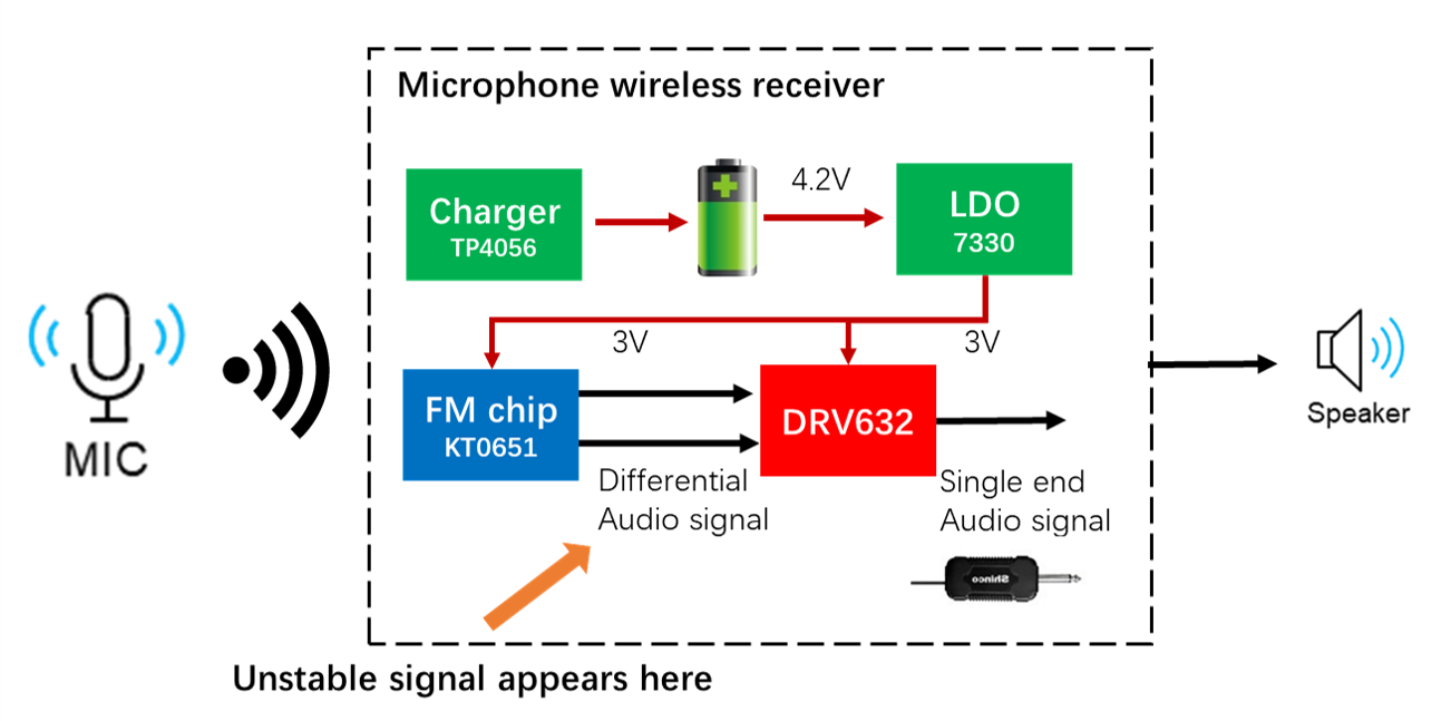

When I used DRV632 to P2P replace AD22650 from AD22650 in the wireless microphone receiver in the same board, it was found that The audio signal of wireless microphone receiver will be disconnected occasionally When I put the receiver about 5m away from the microphone. But there is no such issue when I use AD22650 under the same condition.
Could you please help me analysis that? Because I want to use DRV632 for business reasons problem instead of AD22650.

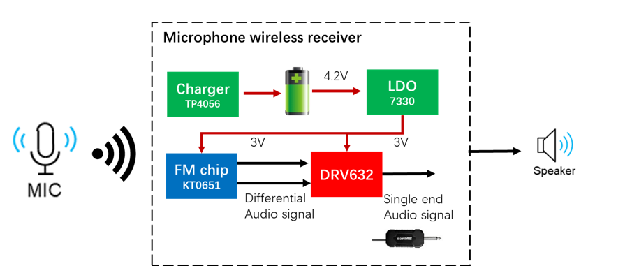

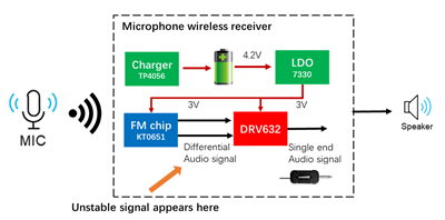

  1. System block diagram

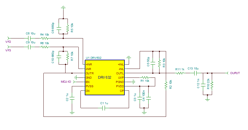

        2. The circuit of DRV632.

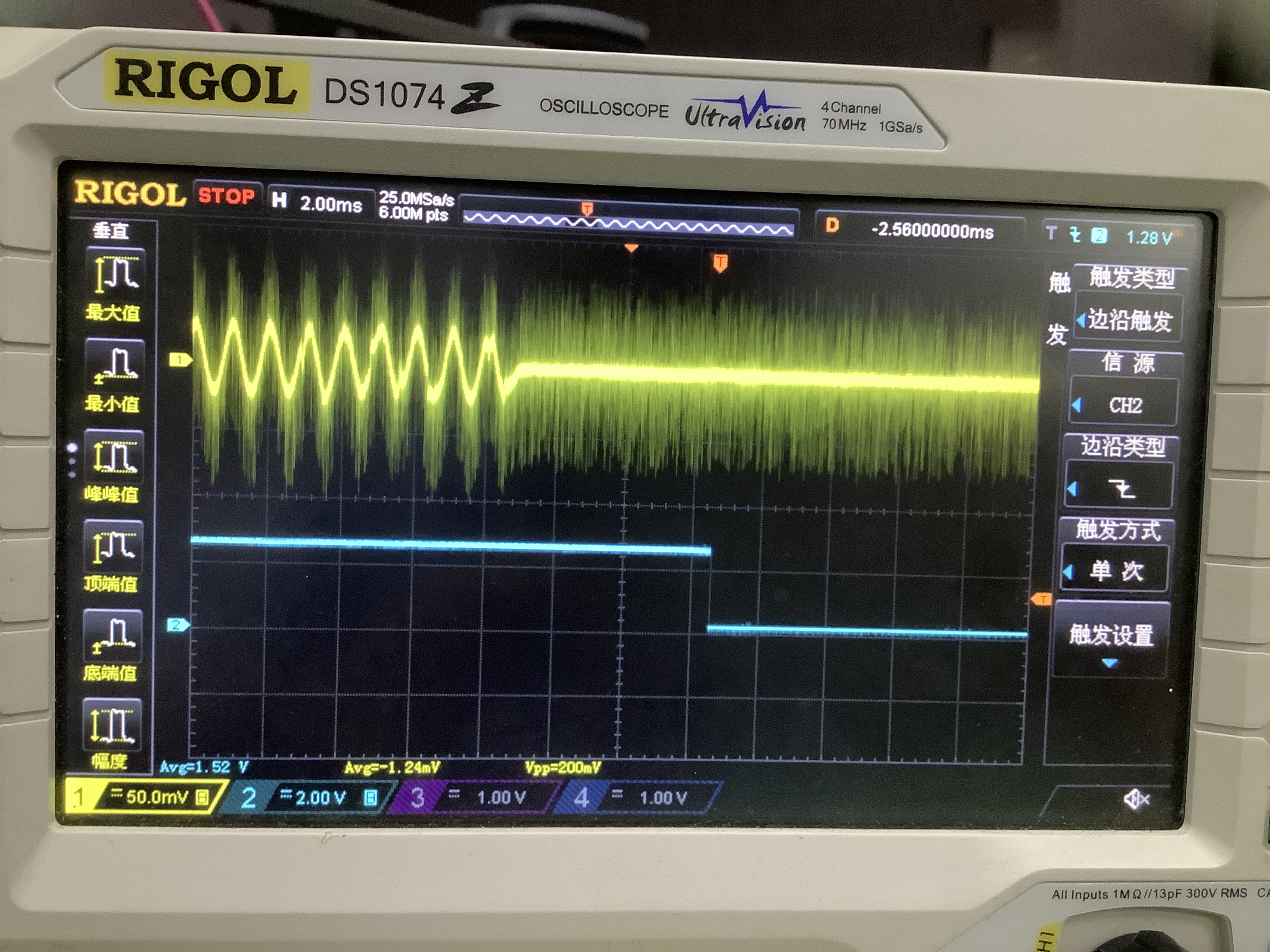

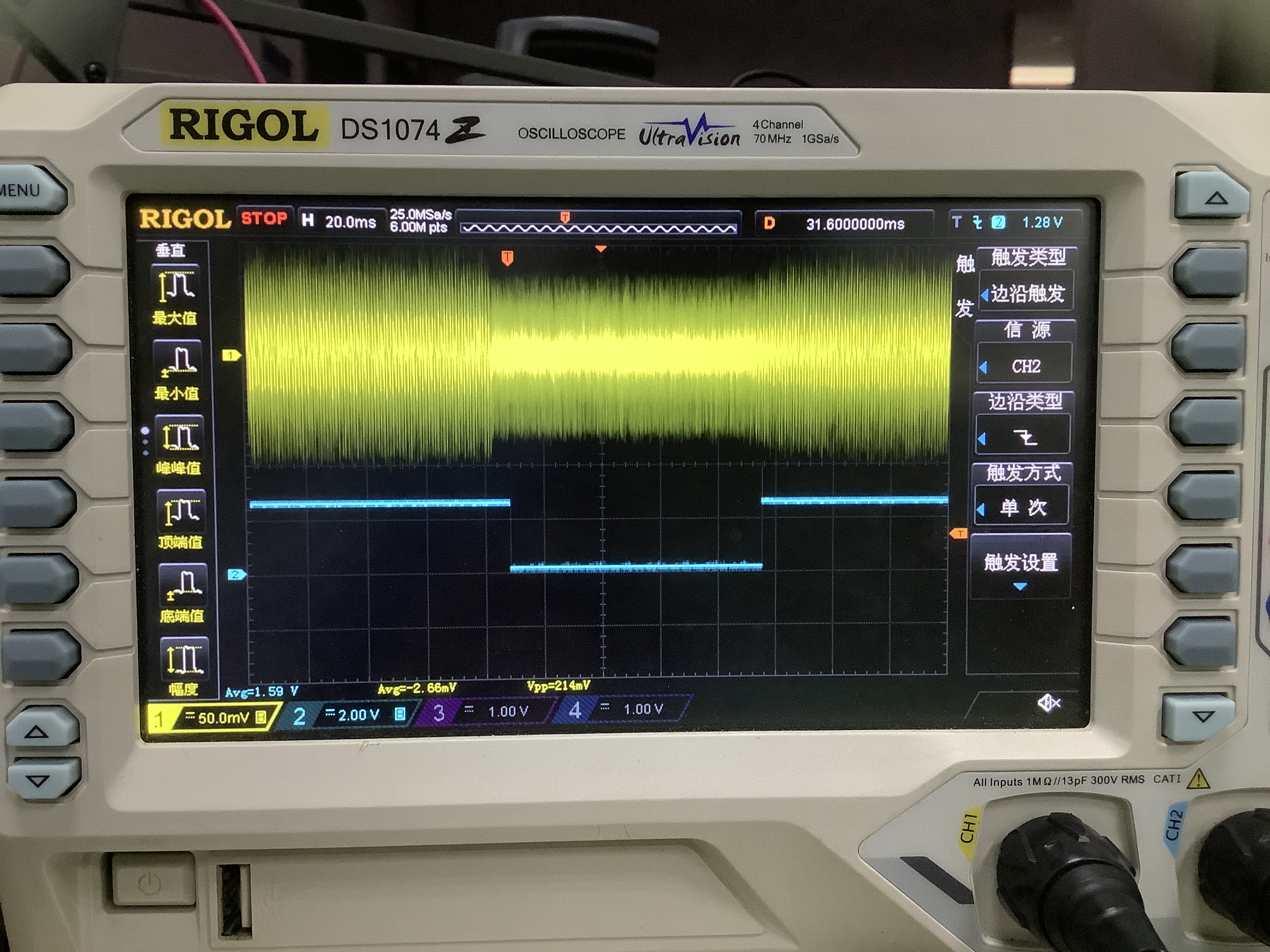

        3. The waveform of the +INR when the audio signal is disconnected occasionally.
             The yellow line is the input signal of 632.  The blue line is the signal of FM chip which indicates the status of the wireless signal connection.
