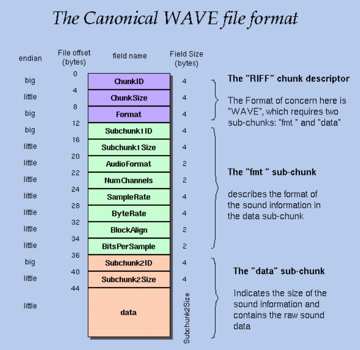

    * Question
    1. About Audio Data (SDIN) of I2S.
      -. When they send audio data by I2S on the STMicro MCU, The header 44byte portion is discarded and only data of wave file is sent.
         I think that this audio data format is able to be issue.
         In other words, Is there any difference data format (SDIN) of I2S between I2STAS1020 and STMicro MCU?
         How should we send data format through I2S interface? or Could you check data format when change from wave file to I2S signal?
         I'm looking forward to receiving your response by tomorrow.
         If you have any other question, let me know.
      -. As you know, below is wave file format.
    Michael

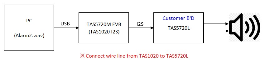

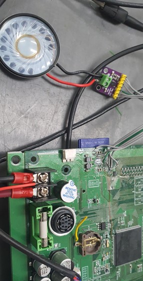

  • Hi Luis or Robert,
    I'm sorry for the rate reply.
    When we compared I2S waveform between TAS1020 EVM and Customer SoC, it was same.
    Here is our another test result.
    If we connect MAXIM - MAX98357 EVM and I2S output of SoC on customer B'D, audio out is OK.
    In other words, I2S output of SoC on customer B'D is no problem.
    I'd like to let you know that some of my comments are missing on my post which is Oct 30, 2020 9:24 PM.
    About below image, only inserted TAS5720L & Peripheral components on customer's bare PCB for test.
    If we use customer B'D which all components are mounted on their PCB, audio out is fail.
    Here is my another question.
    It seems like that there is another root cause not I2S signal.
     -. If there is some noise or other issue on customer B'D except I2S signal, is it possible that TAS5720L audio out is fail?
    Could you please check it and let me know your opinion?

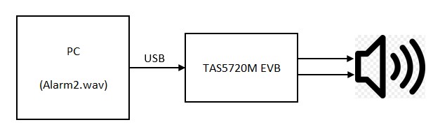

    On my side, may you do experiments below?
    1. Please just use your PC and TAS5720L EVM board, can you make sound out?
      1. If yes, read out all the register above for my check. (play alarm2.wav file)
      2. If not, please refer to the EVM user's guide to make it work normally.
    2. If you can work the EVM board, then re-do the experiments above (PC-TAS1020 I2S --> (disconnect TAS5720 in EVM by modify the resistor to determine the i2c address ) customer's board) --> Isolate I2S from SoC in customer's board --> make sure shared GND --> redo the initialization
      1. to check all i2s is exactly the same as former EVM, then read out all registers for my check
      2. To check whether you can work the customer's board.
    3. If you do have the audio precision in your lab, please use the AP as audio source, it would be better.
    BR,
    Alix Wan.

  • Hi Michael,
    For your experiment: PC--> USB --> TAS5720 EVB (TAS1020) I2S --> customer B'D, you claim that:
    1. OK: only inserted TAS5720L & Peripheral components on customer's bare PCB for test.
    2. Fail: If you use customer B'D which all components are mounted on their PCB, audio out is fail
    3. You claim I2S from TAS1020 is exactly the same as SoC's
    Then the results do not make sense on my side. It seems that other components mounted on PCB in customer's B'D 'affects' the results. Then:
    1. With OK, bare PCB for test, please capture one complete MCLK/LRCLK/BCLK/SDIN by playing a SIN wave;
    2. With fail, mounted PCB for test, please do captures waveforms above for comparison.
    Further, may you confirm your tests on TAS5720 EVM board?
    1. Fail: STMicro MCU -->TAS5720 EVM board
    2. OK: TAS1020 --> TAS5720
    For all the tests above, we are confident of i2s from TAS1020, but chances are that board may be damaged. Hence, to sync up our test. It is strongly suggested to use Audio Precision (AP555, AP2700) for the audio source as we believe that should be correct. May you have a try?
    BR,
    Alix Wan.
