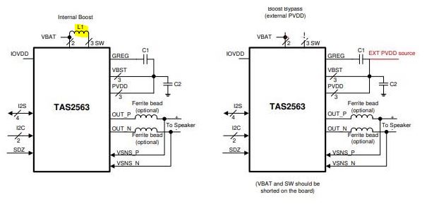

TAS2563: Can We Install Inductor in TS2563 Boost Bypass Mode?
Part Number: TAS2563
Hi Sirs,
As title, based on the FAQ at
Can we install the inductor (marked below) in boost bypass mode (page 0x00, register 0x33 = 0xc4)?
Will it cause silicon damage or performance downgrade if we don's remove the inductor from the hardware?
