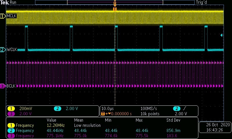

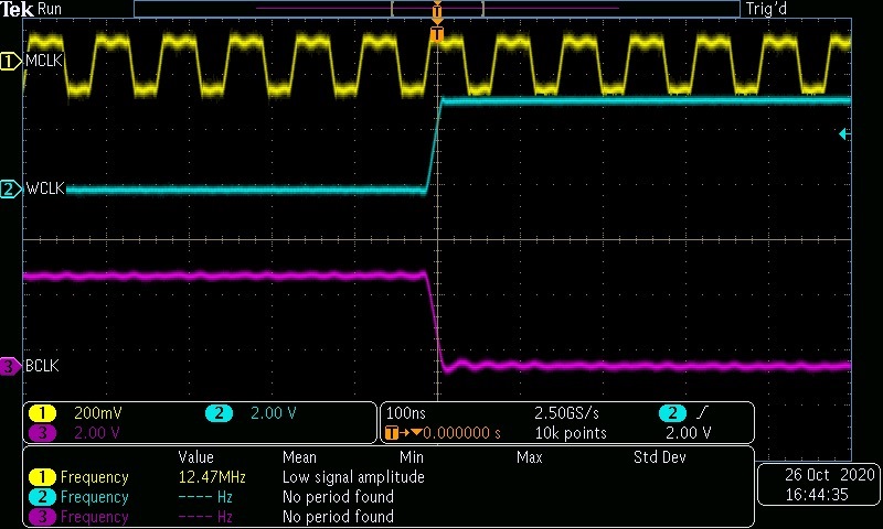

  • We have got almost better waveforms in I2S and MCLK lines as attached.(without any series termination). (We tried 33Ohm Series termination as well.)

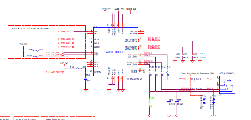

  • Our Audio output implementation as follows.
Kindly help us to reduce the Noise issue we are facing on the Output Audio. Your support is highly appreciated.

    Schematics for your reference.
  • Hello Jomin,
    Can you reupload an image of the schematic? For some reason, it is not showing up. Since you are inquiring about the AIC3109-Q1 EVM in another post, are you using the EVM here or is this a custom board?

  • I hope the attached schematics is OKe.
    It is a custom Board and we are using the AIC3109-Q1 codec on the board. We were using EVM for our initial development activities.

  • Hello Jomin,
    It also looks like the WCLK and BCLK are misaligned. Please refer to the image below taken from the data sheet that shows the WCLK edges should be aligned with the rising edges of the BCLK.
    I would also like to ask about your clock signals. Form the above images, is MCLK to be 12.288MHz? And I assume you are not using the PLL as it is disabled. Is this correct? If you are not using the PLL, please also write 0x01 to register 101. This will select CLKDIV_OUT for the Fs. By default it is selecting the PLLDIV_OUT path.
    Aaron
