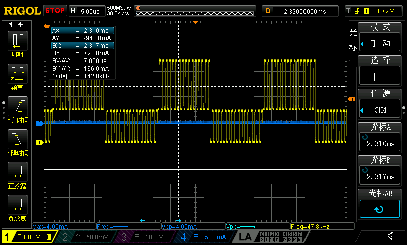

My customer is designing automotive cluster with TAS2505-Q1. 2 pcs of TAS2505 (relatively low PPM) is reported to output loud noise sporadically but can somehow self recover w/ or w/o reconnect power.
The only abnormal thing captured is identical WCLK/BCLK error waveform as below. Page 0 reg 27 is set to 0x00 (I2S 16 bit WCLK/BCLK input).
I've also attached the weird noise. Any idea on where the problem is or what test should I do next?
