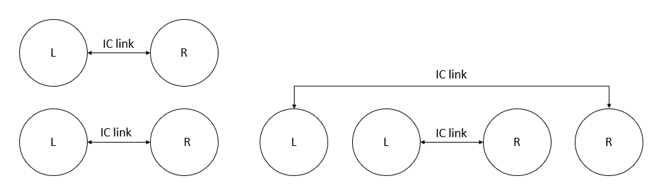

  • Hi Mats,
    How will this speaker array be arranged? 2x2? 4x1?
    What is the end application for this speaker array? a tablet or other device that will be rotated during playback? the devices could be linked in pairs and you will be able to maintain stereo balance of the audio.
    Arthur Brown
  • Hi, and thank you for the helpful information so far!
    Yes, the array will be mounted in a single device, but the device will most likely be mounted/fixed in either a 0 degree or 90 degree position so it will not be rotated while powered. We are still in early design phase though so it would be preferable if we could test several arrangements (including 2x2 and 4x1) - for the evaluation board we are designing now we have the possibility of changing speaker positions around for testing.
    In your 2x2 example picture, I guess stereo balance would not be maintained when rotated 90 degrees? If we can only link 2 speaker amplifiers at the same time(?) then would f.ex. a solution with some kind of external multiplexing of the IC link signals for each position work?
    Mats Jonassen
  • Hi Mats,
    Yes, in the 2x2 example stereo balance would be lost when rotating the setup 90 degrees. I am looking into the possibility of linking 4 devices.
    Arthur Brown

  • Hi Mats,
    In order to use an adjustable arrange of channels, you can use multiplexers or switches to toggle the signals between the devices.
    Please feel free to take a look at our portfolio here:
    One of the devices we use on our designs, the PurePath Console 3 motherboard, is SN74CB3Q3253RGYR if you want to take a look.
