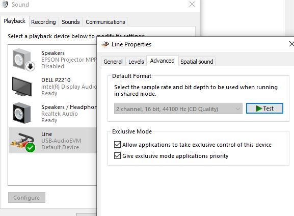

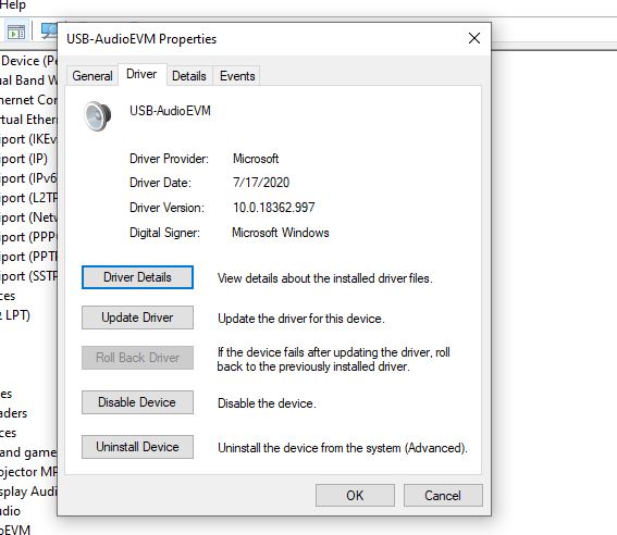

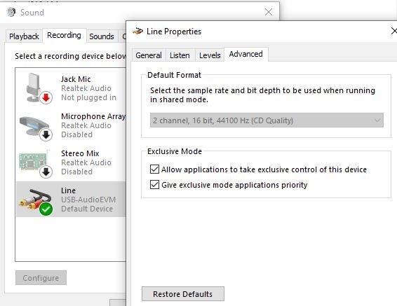

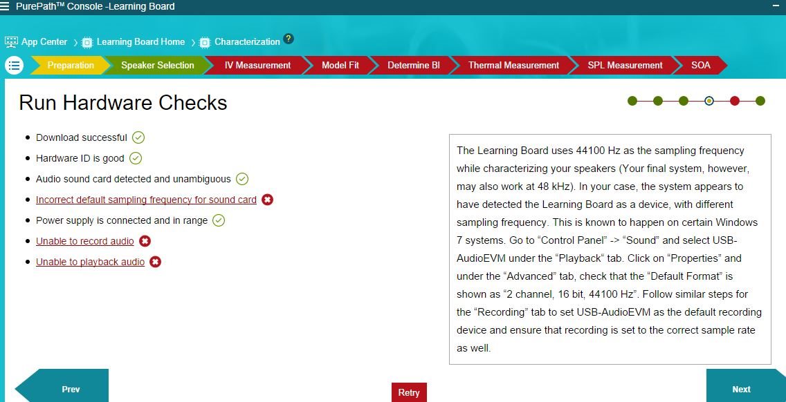

I applied a new PP-SALB-EVM but got hardware check failure. Would you please advise how to solve it on Windows 10? I tried to uninstall and reinstall the USB-AudioEVM but it was in vein (it worked with my previous EVM but keeps failure this time).
Playback Sample Rate = 44.1kHz
Record = 44.1kHz
Deriver version (auto installation when plugging the EVM)
PPC3 Fail Message

  • Hi Wayne,
    Please check:
    1. Go to device manager to find the driver and uninstall it;
    2. Connect back to learning board to have it installed again;
    3. To check playback and record as you did above again;
    4. Then set the volume of PC to 100
    5. Check again to see whether this issue is eliminated;
    6. Try another PC to avoid any potential OS issue.

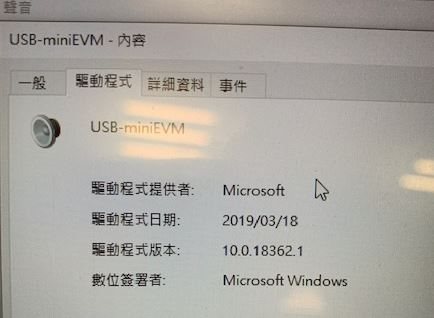

  • Hi Alix,
    Customer and I confirmed that the Microsoft inbox driver version of 10.0.18362.1, released on 2019/03/18 works with PP-SALB-EVM and TAS58XX EVMs on Windows 10 with no issue.
