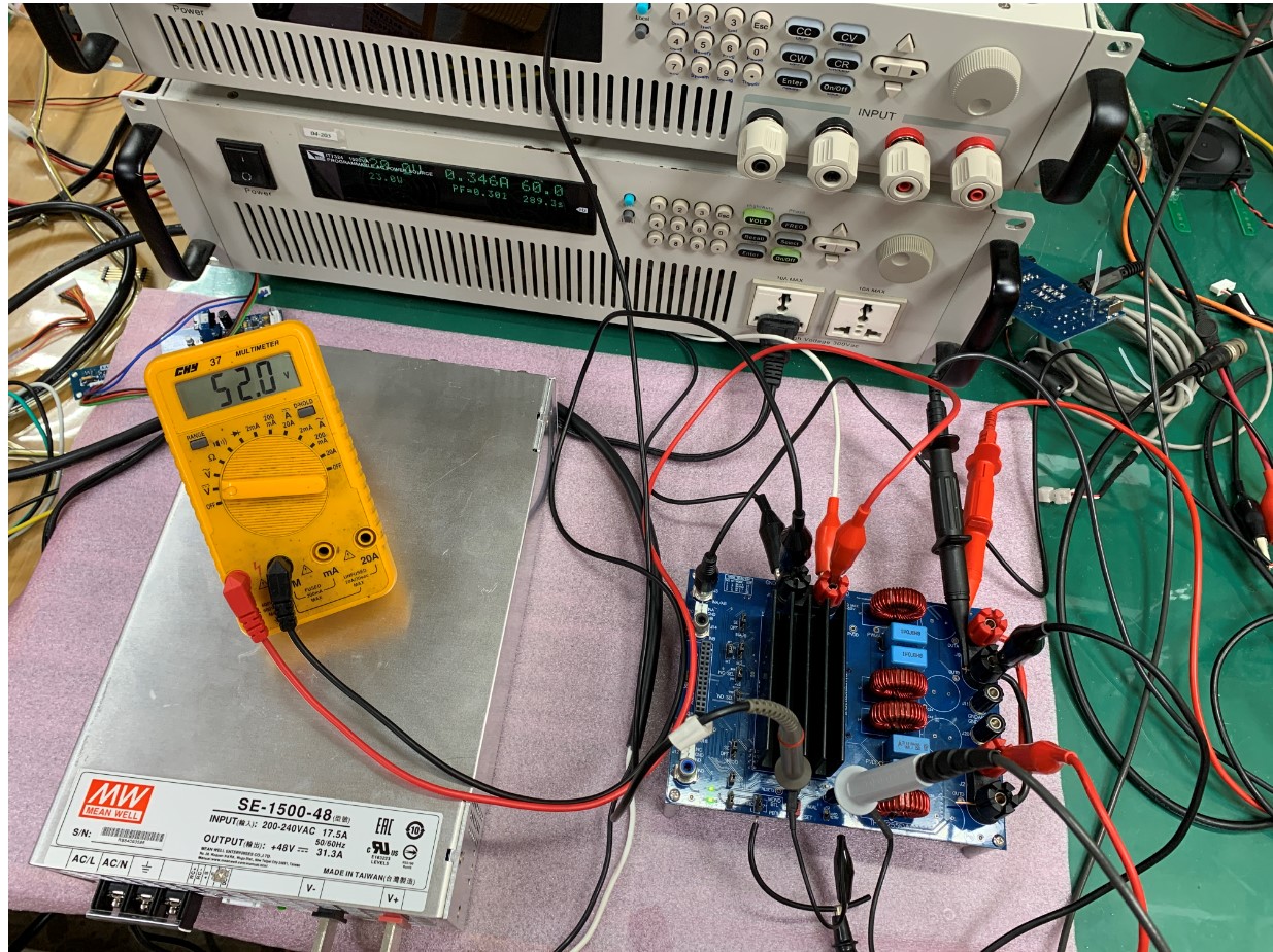

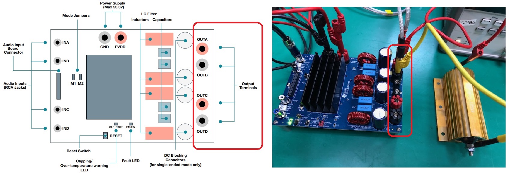

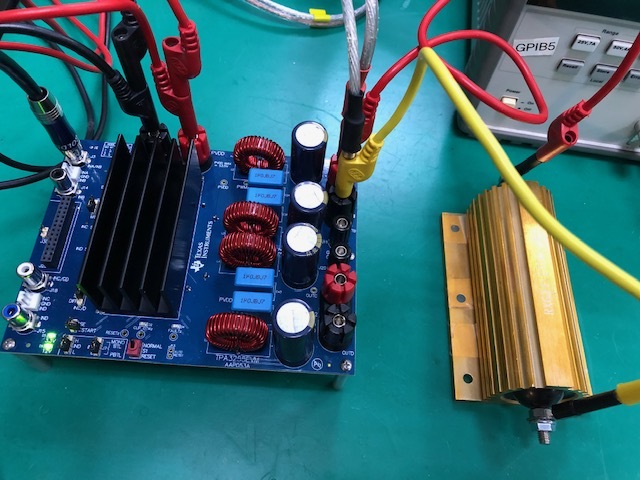

Hi Sir,
I have a problem, for load 2~4ohm enter to PBTL Configuration, would you please take a look and provide the suggestion can meet datasheet 600W Mono?
Vin=52V , 1KHz Frequency
1.the out pin : FAULT=0,CLIP=0
2.Mode=PBTL ,M1=0; M2=1,J7/J8=0

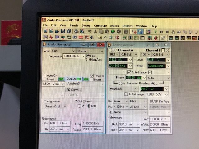

Output RMS=31.5V
The 2~4ohm load test result as below:

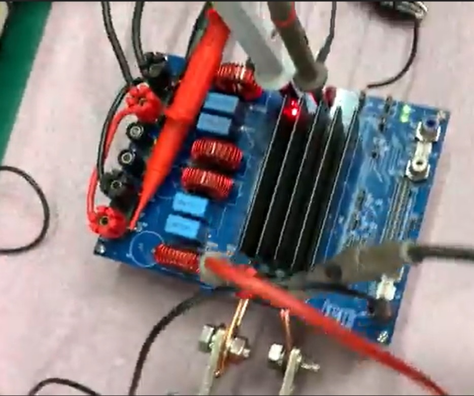

CH1=CLIP_OTW  CH2=Fault  CH3=Output
PVDD=52V,output Fail 1KHz/31.5V RMS/Load 3ohm
https://drive.google.com/file/d/1AZfZT3Nou4KwBso9Vvll7auueCtyW6BL/view?usp=sharing
PVDD=52V,output Fail 1KHz/31.5V RMS/Load 2ohm
https://drive.google.com/file/d/18izOBRv0QONq5CTya3ZbP_VXhsT-cafV/view?usp=sharing
