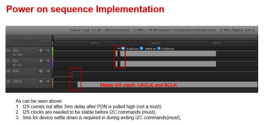

Customer design TAS5805M as audio amp solution in STB application, but face to audio noise(zi-zi noise) after start up.
This audio noise will disappear if we turn up/down sound volume. Could you guide us which items should we check first? Thanks.
BTW, customer have follow with device power up sequence requirement in below pic.

    As you said, then pls capture the waveform of BCLK, SDA, PDN for my check of their power on sequence.
    Further, .ppc3 file is key for double check too.
    Further, when noise comes out, use the enclosed file below for double check: (0x58 is the i2c address, w means write, r means read)
