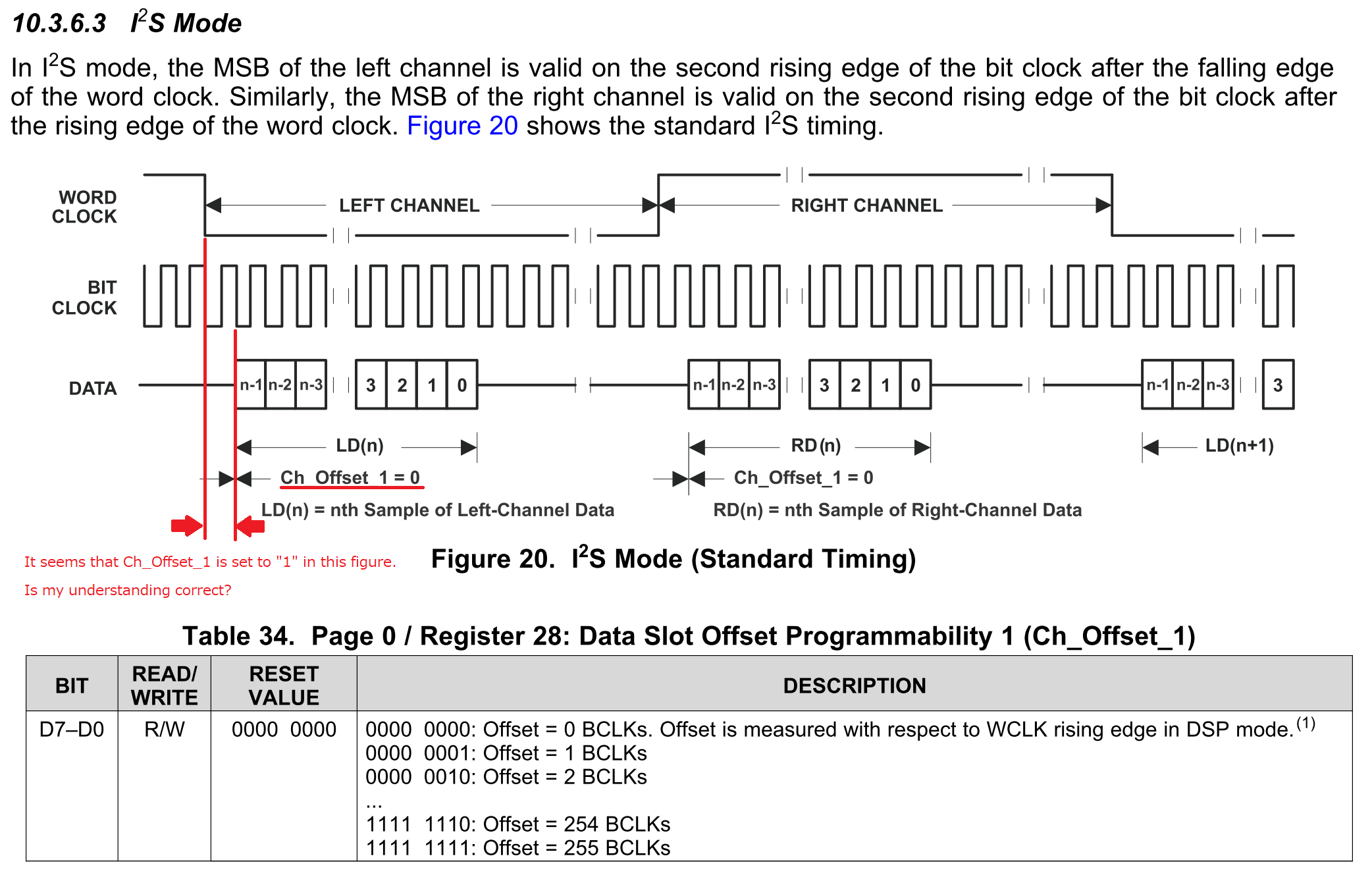

For I2S mode, the timing chart is mentioned on page 19 of TLV320ADC3101 data sheet. So, it seems that Ch_Offset_1 is set to "1" in this figure. Is my understanding correct?
If Ch_Offset_1 is set to "0", the following figure should be correct.
