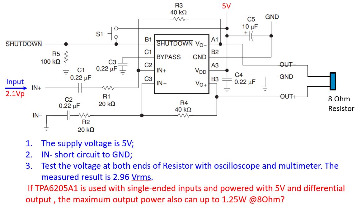

Please help to double confirm. When TPA6205A1 is used with single-ended inputs and powered with 5V and differential output , What is the maximum output power ?
For example, in the following circuit, what is the maximum output power from TPA6205A1 to the 8-ohm speaker (@<1%THD) ?

Even if the speaker is connected as differential output, the output is actually considered as single-ended (VIN+ is at the reference voltage, so VOUT+ will be 0V).
The maximum output power at 1% THD+N is 1.25W for differential output. As stated in the datasheet, the output power for single-ended mode will be 4x times less, which results in ~0.3125W (1% THD+N)..

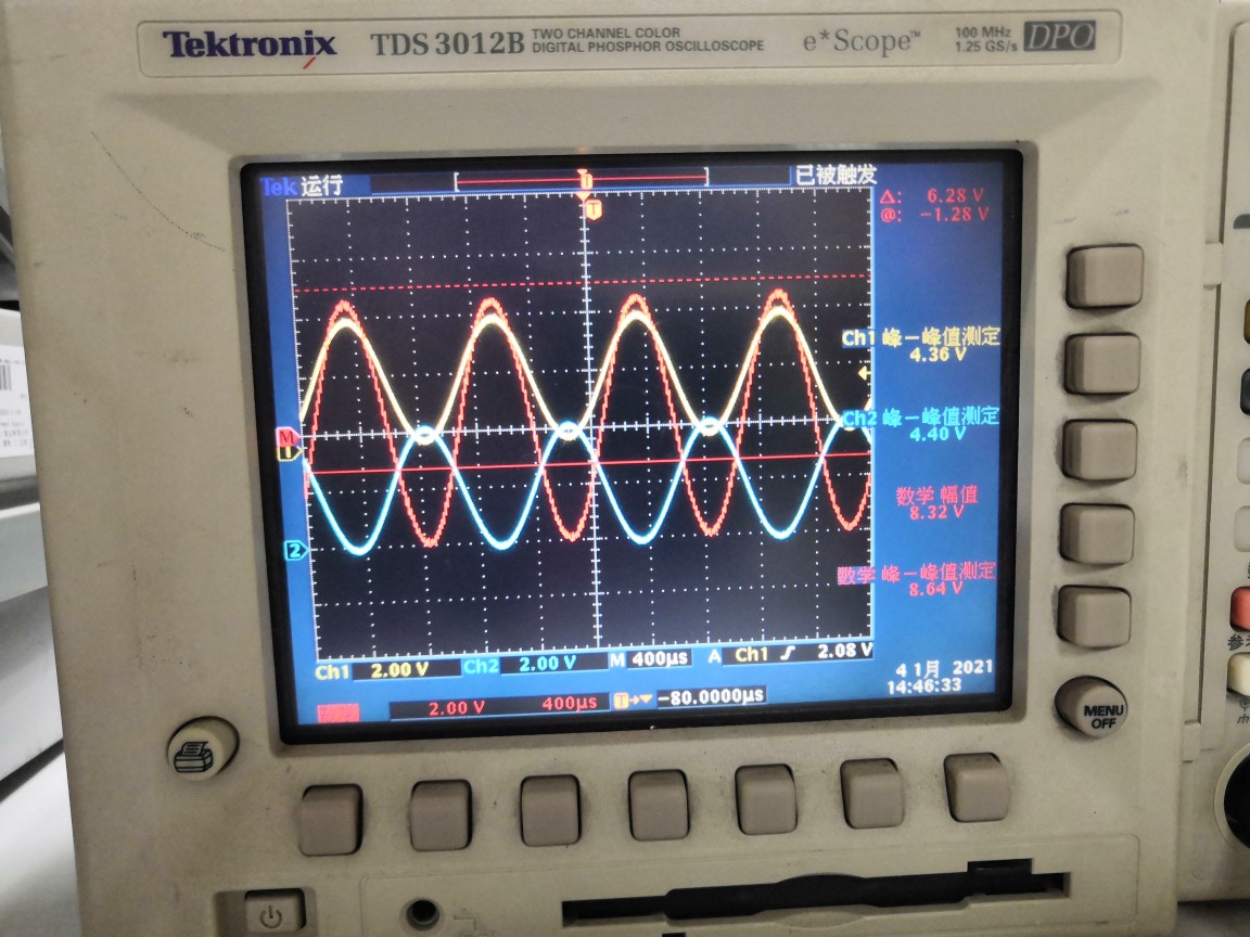

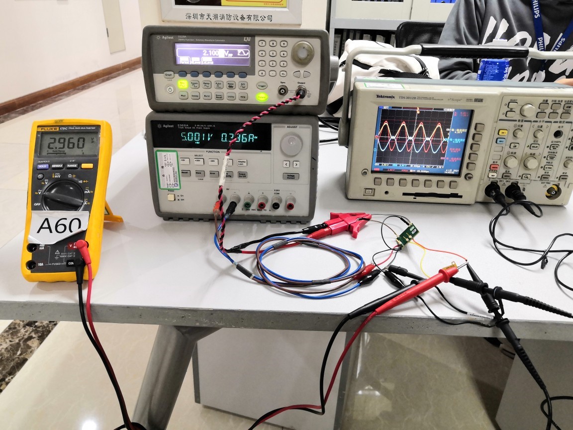

hi Luis,
My question is simple. When IN- short circuit to GND, What is the maximum output power? You told me, when IN- is grounded, the output is actually considered as single-ended, even if the speaker is connected as differential output. But my test results show that's not the case. You need double confirmation.

I searched for more information and you are alright. The maximum output power is actually dependent of the power supply. Even if you use a single-ended or differential input, the differential output will be always dependent of Gain x (IN+ minus IN-). However, Vo+ and Vo- are limited to the power supply level. So, if you are using a 5V power supply, you should expect a maximum output of 5V on each output. This will result in a maximum output of 1.25W, which coincides with the THD+N vs output power plot of the datasheet (figure 7).
