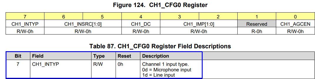

There are CHx_INTYP bits as below;
What is the difference of the internal circuit between AC-coupled input and DC-coupled input?
Any variation is not seen even if this register is switched.

The CHx_INTYP settings do not change any internal analog or digital settings in the device. The intention of the CHx_INTYP registers was to provide a way for a host processor to read back a setting that would indicate how the board and ADC channel was configured.
