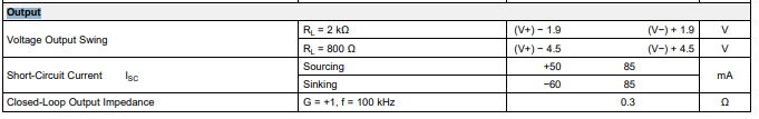

I would like to use 8 x OPA1632's in my 8 channel preamp design with OPA143 's to buffer VQ ( VCOM ) from 8 channel ADC.
looking at typical application design in the datasheet it says "Power supplies as low as ±8 V can be used in this application with excellent performance"
I would like to power the device with ±5 V with input signal coming from PGA2500
input = 8.2Vpp ( -4.1v to +4.1v) on the input
output = 6Vpp ( -3 V to + 3 V )
with +2.5 V bias on VCOM for the output of between - 0.5 V to 5.5 V
Can you tell me if +/-5V power would work in the situation ?
the part says it can run down to +/-2.5V but i'm not sure how much head room is required for given voltage swing.
If not , can you recommend a TI part that would be good for this ADC buffer in the +/-5v power range?
I'm looking at reducing the gain by around 25% which is the same as the example although I will need to add some
filtering to the design.
