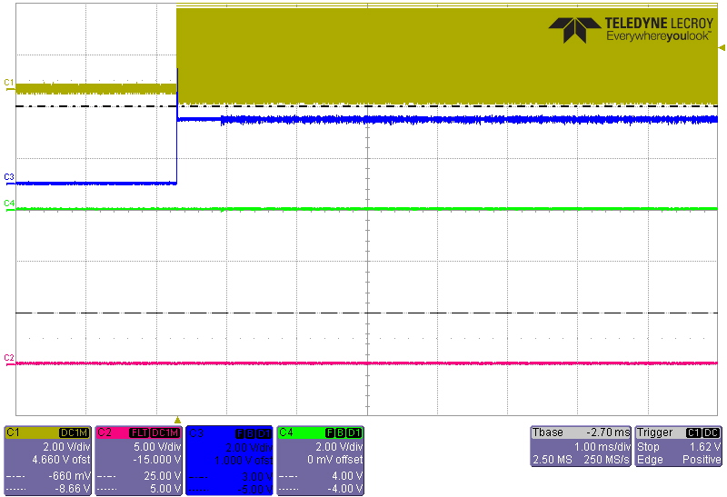

  • Hi Paul-san,
    >1. What digital clock signals are present during this event?
    LRCLK and BCK/SCKL
    2. Are the power supplies at their final voltage when reset is released? (5V and 3.3V)
    Yes.
    3. Can they use an oscilloscope to capture the behavior?
    Please see the attached file.
    The inside red rectangle is a pop noise waveform.
    PCM1690.xlsx

  • Hi Kuramochi-san,
    Sorry for the delay.  I am confused at the voltage scale of the scope shots you shared.  Is the red line being gained up by some other stage? Is the scope calculating this line, or is the output of the differential-to-single-ended amplifier stage?  Does the glitch change if DIN = 0 during the reset event? Is it possible to mask the SCK signal with the digital RST input?
    Paul
  • Paul-san,
    Thank you for your reply.
    The red line is calculated by the oscilloscope.
    The yellow line and the blue lines are monitored directly.
    I'll check it.
    What does "mask" mean?
    When should we input digital RST?
    Kuramochi

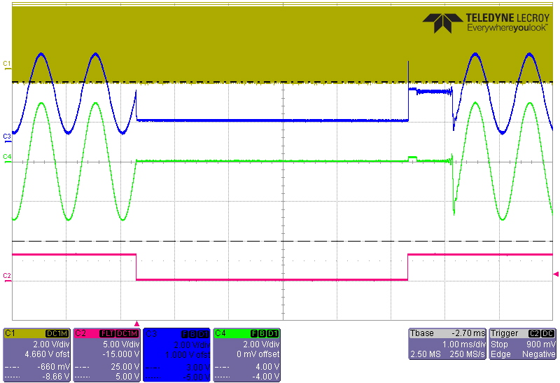

  • Here are two images:
    Yellow: SCK input
    Red: RST signal
    Blue: VOUT1+, totally unfiltered (except scope filtering)
    Green: VOUT post LPF, single-ended to differential amplifier,
    You can see the glitch in this image.

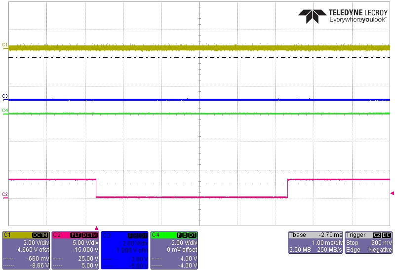

    Second image:
    Yellow: SCK input
    Red: RST signal
    Here you can see that the output is stable after exiting reset and all the I2S inputs are disabled.

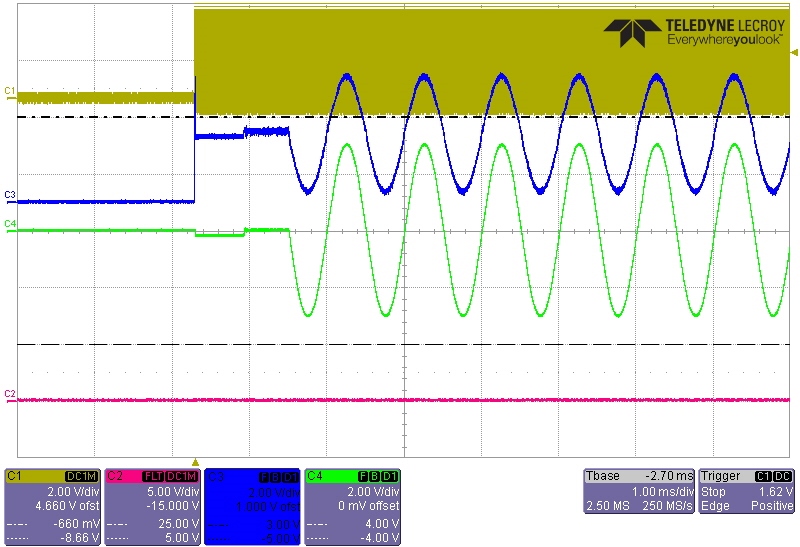

    In the case where I2S data is applied after the reset is complete, it is still possible to see a glitch.  In the below image, all I2S inputs are resumed at the same time, and DIN is non-zero.
    One way to reduce this glitch is to enable SCK, but keep DIN connected to LOW.

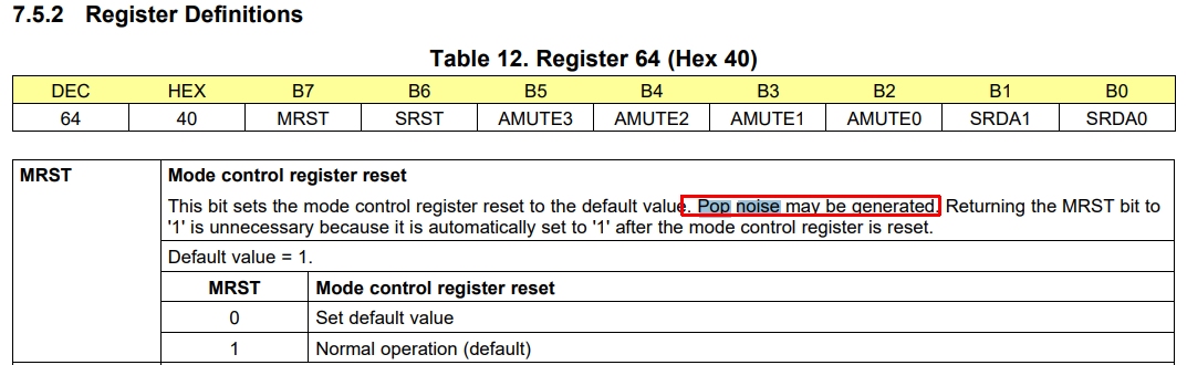

    And I found the following in the datasheet.
    Is this "pop noise" stand for the phenomenon in this time?
    If yes, I think that pop noise can not be avoided.
    Kuramochi
  • Hi Kuramochi-san,
    As you can see in my last image, there is still a small transient on the VOUTx+ line, but I found a similar transient on the VOUTx- line as well and I did not see any after the transient.  It is possible that in their system (or in some devices) this transient can still be heard.
    It is possible that a pop noise cannot be avoided without external muting.  Does their amplifier stage features a SHUTDOWN or MUTE stage?
