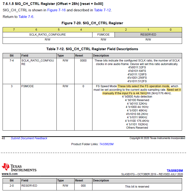

Due to the fact, that biquads are calculated for 48 kHz, it's needed to do a sample rate conversion from 44.1 to 48 kHz. I found some info in the datasheet on page 48:
I have 3 questions:
1. Is it necessary to set SIG_CH_CTRL register manually to 44.1 kHz when using that as input sample rate?
2. Does the src module convert 44.1 kHz to 48 kHz to have correct filter setting? Or does the src just do some minimal resampling to have the correct multiplication factor between lrclk and sclk?
3. Is that a typo in the datasheet, because FS_MODE is just bit 3, but the configs require 4 bit, so it should be bits 0-3 for FS_MODE?

  • Hello Markus,
    The default configuration is autodetection so it doesn't necessarilly need to be configured manually.
    For SRC module, "As input" can support 32, 48/44.1, 88.2/96 and 192KHz depending on the process flow.
    You are correct it should be 4 bits for FS_MODE.

  • Hi Luis,
    if the autodetection is able to recognize 44.1 kHz, why is it written in datasheet to manually set that register if 44.1 kHz is used? Doesn't make sense to me yet.

  • Hello Markus,
    Sorry for the confusion.
    The reason for "setting it manually If the input Fs is 44.1kHz/88.2kHz/176.4kHz" is that TAS5825 does not make a difference with 48kHz & 44.1kHz, 96kHz & 88.2kHz... which means the PLL frequency factors are the same.
    If you do not mind the PWM switching frequency varies between 384kHz & 354.2kHz you can use default Auto detection configuration.
    For the process flow you are using you would need to change the base sampling rate(which is the DSP sample rate) to as input so the process flow will be operating properly otherwise you might need to use a process flow with a bank switch to keep the Biquad frequency response in sync.

  • Hello Markus,
    When you set the Base sampling rate(which is the DSP sample rate) it will calculate the biquad coefficients based on what you set as the input sampling rate.
    The biquad banking is used specifically to make sure the frequency response is matched closely between 44.1k/48k input signal as without bank switching the frequency response will be still be very similar but not exact since the coefficients would have been calculated for one specific sampling rate as the DSP when processing data won't really distinguish between 44.1k/48k and 88.2k/96k and 176.4k/196k.
    The SRC overall has up and down sampling for these multiples, but essentially treats 44.1k/48k the same it doesn't convert 44.1k to 48k.
    1/12x, 1/6x, 1/4x, 1/3x, 1/2x, 2/3x, 1x, 3/2x, 2x, 3x, 4x, 6x, 8x, 12x, 24x.
    If you test on an EVM 44.1k will work on a 48k flow but EQ frequency response might be slightly different compared to a 48k, and the switching frequency will be different.
