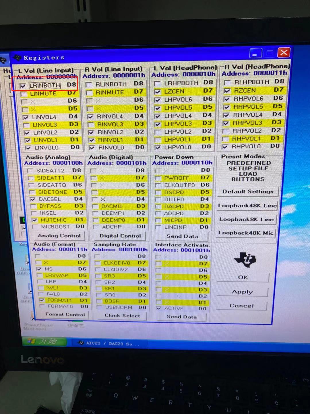

Hi all,
  I have a problem about register REG LRS/RLS  Left/right line simultaneous volume/mute update  for Left/right line input channel volume control (Address: 0000000   Address: 00000001).
 1、 First,I choose the LRS bit, then i chnage the L VOL D4 D3 D2 D1 D0 from 10111 to 10001,and i find that only left channel volume is changed,however,right channel volume don't change.Normal,i think that right channel volume should be also changed.please see following picture,
2、I choose the RLS bit, then i chnage the  R VOL D4 D3 D2 D1 D0 from 10111 to 10001,and i find that left channel volume and right channel volume is changed simultaneously..please see following picture,
  Why is there such a difference between the LRS and RLS ?
  Looking forward to your reply.
 BR!
  GUO

  • Hello Aaron,
       I use TI's official software AIC23 GUI 3.0.
      And i use another I2C software to configure the register about LRS\RLS. I found that the LRS or RLS left channel volume and right channel volume is changed simultaneously.
        Why is there such a difference between the  two software?
    GUO
  • Hello GUO,
    I suspect there may be an error here in the software. This device and software is quite old so I cannot speak with 100% certainty. Regardless, I am glad you were able to confirm with an I2C write with different software.
