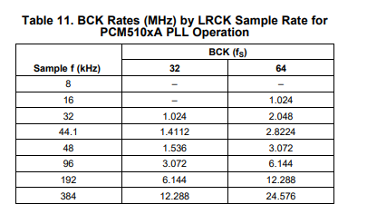

The audio DAC PCM5102A is used on our PCBA to play audio. The audio to be played have 2 types of sample Rates: 22.05KHz and 24KHz
Now we have one problem: During the PCBA mass production, 10% of the PCBA boards can not play the audio with 22.05KHz sample rate. While it can play 24KHz sample rate audio normally.
On our PCBA, the PCM5102A is designed with following configuration:
  • 3-wire I2S slave, which means that BCK, DIN and LRCK signals come from the I2S master (MCU act as I2S master on our design).
  • PCM5102A's system clock input (SCK) signal connects to GND through one 10Kohm pull-down resistor. It means that it means that we choose "Clock Slave Mode with BCK PLL to Generate Internal Clocks (3-Wire PCM)". Neither LRCK = 32 * Fs (sample rate) nor LRCK = 64 * Fs (sample rate) can play the 22.05KHz sample rate audio.
  • PCM5102A's FMT signal also connects to GND through one 10Kohm pull-down resistor, which means the audio data format is configured to be I2S Audio Data Format.
  • PCM5102A's XSMT signal connects with VDD (3.3V) directly.
As the failure rate is actually very high, Please give a quick and strong support. Thanks.

    1. I suspect your problem is rooted in that the PCM5102A does not support either 22.05kHz or 24kHz audio in 3-wire mode.  In 3-wire mode, the PCM tries to detect the input clock frequency and configure the device automatically.  It will attempt to use settings for detectable ranges.  When you use a rate that is un-supported, the device usually just autoconfigures for the nearest supported frequency, but that is not guaranteed.  Generally, I see when customers use 22.05kHz or 24kHz, the device auto configures to the 32kHz configuration.
    I do not recommend you use BCK=32×FS, only BCK = 64×FS.
    In addition, the device requires that the BCK signal be continuous.  And by that we mean that the there are no interruptions in the clock.  Some I2S sources will use a higher frequency BCK, but then gate the output after 32 bits.
    Assuming you are using a continuous bit clock, you could try connecting SCK = BCK.  This would put the device in 4-wire mode, and which usually allows the device to operate even if it cannot determine the LRCK frequency./

    Checked the datasheet of PCM1780/81 and PCM1754
    Below picture is copied from the PCM1780/81 datasheet.
    Below picture is copied from datasheet of PCM1754
    22.05KHz and 24KHz are not found in the datasheet of PCM1780/81 or PCM1754. Here want to check with you whether PCM1780/81 and/or PCM1754 supports 22.05KHz and 24KHz or not. If not, then any other devices without I2C or SPI may support 22.05KHz and 24KHz?
    Thanks.

    1. Both the PCM175x and PCM178x can support 22.05kHz and 24kHz in a four-wire configuration with a valid SCK multiplier (256xfS, for example).
    2. Let's go back to basics on the PCM510xA board before we commit to this being an issue with the sample rate.  Let's check the following on one or more of the failing boards:
    a. Can you share your schematic for review?
    b. When your clock signals are applied in the 3-wire configuration, what is the voltage on the VNEG pin? What is the voltage on the LDOO pin?
    c. Do you measure a valid voltage on all supply pins? VDD, DVDD, CPVDD?
    d. If you connect an external I2S source (might need to wire to the board) and play a supported sample rate (e.g. 48kHz), does the DAC now work?
    I would like to eliminate other possibilities before we come to a conclusion, as I would still expect the PCM510xA to have some functionality at 22kHz, just somewhat limited performance.
