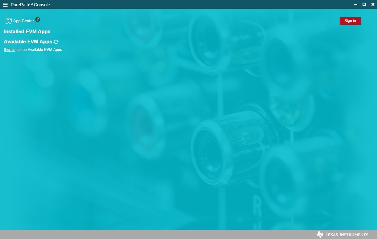

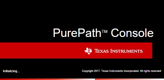

    There were two screens showed up after I double click the PPC3 from the menu.
    First
    Second
    After the second screen, it closes right away.
    Gilbert
