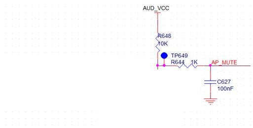

thank for your feedback, I have checked the STANDBY pin spec, but I found which is different between datasheet spec and my test. as below:
STANDBY PIN current is max 0.2uA, but MUTE current is about 140uA according to the test result(detail as below).
customer schematic:
Detail:
VAUD_VCC = 3.343V
VTP649 = 2.642V
VAP_MUTE = 2.493V
please help to confirm it on the EVM and clarify this issue, thanks very much.
Xiaowei,
Please remove the capacitor and measure again. This can be a source of leakage current.

Hello Xiaowei,
I used a Keithley 2420 Sourcemeter to measure the current in the Standby pin when forced to 3.3Vdc without a series resistor. The current is measured is less than 0.001uA. I set the forced voltage to 2.493Vdc and I have the same measurement of 0.001uA.
I used my voltmeter to measure the voltage on the sourcemeter. The voltmeter current draw was 6.5uA. Your 140uA may be your voltmeter current measurement needs to measure the voltage.

Hello Scott,
I just confirmed the result from customer. actually this phenomenon is happened when TAS5411 going to STANDBY status, and it work well during TAS5411 in active status.
so do you think which is normal phenomenon? thanks.
Xiaowei
Xiaowei,
The internal structure of the MUTE pin is the same as the STANDBY pin. The Mute pin can have a bit more current when in standby mode when pulled high. I measure 136uA.
Hello Scott,
thanks for your support and clarification. so I think that is the normal status, right?
Xiaowei
Xiaowei,
This is normal for the Mute pin when the device is in Standby mode. Please click Solved if this as solved your questions.
