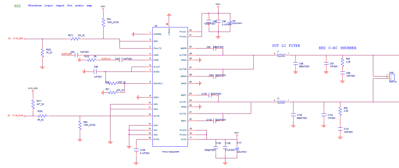

TPA3116D2: When I use a load of 2ohm, THD+N and flatness of Frequency response become very bad.
Part Number: TPA3116D2
I use one TPA3116 amps in my circuit. In my circuit I use a single supply +24V.
In order to get 100W output power, I use the MONO MODE (PBTL) .
When I use a load of 8ohm, the performance index is very good. The THD+N and flatness of Frequency response are all good, the flatness is ±0.1dB(40Hz~16KHz).
But when I use a load of 2ohm, THD+N and flatness of Frequency response become very bad. The flatness becomes ±2dB(40Hz~16KHz).
The schematic diagram is just as the  reference design in Datasheet.
How can I fix this problem ?
