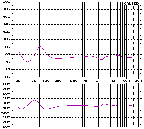

    • We use resistive loads and not loudspeakers since loud speakers have varying impedances across the different frequencies. Sounds like you have tested it with a loudspeaker. Do you have it's impedance over frequency graph?

    • We use resistive loads and not loudspeakers since loud speakers have varying impedances across the different frequencies. Sounds like you have tested it with a loudspeaker. Do you have it's impedance over frequency graph? Yes ! You are correct .
  • Hi Andreas,
    Thanks for clarifying the system that you are testing with. If possible, I recommend testing with a purely resistive load and checking the results. As I don't have the schematic, it's possible there might be something else limiting the frequency response of the system. Removing as many variables will help better pinpoint where this limiting factor is coming from.
