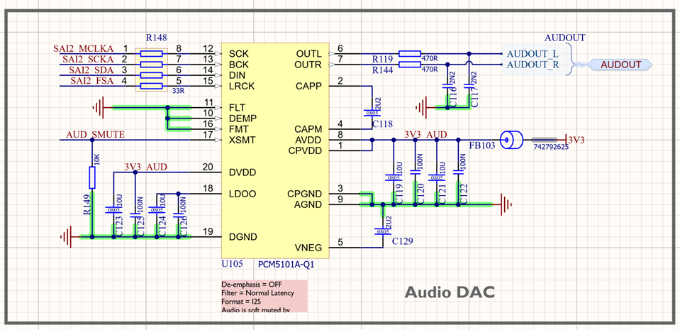

PCM5101A-Q1: Schematic review
Part Number: PCM5101A-Q1
I am thinking of using PCM5101A-Q1 to convert I2S to analogue audio. Output needs to be Line out at 2Vrms max. They will be connected to an external unspecified audio amplifier (which is our end user's responsibility).
Please let me know if this circuit is ok. I2S and logic is at 3.3V levels. Net name 3V3 is supplied from buck regulator.
Thank you very much in advance, your assistance is much appreciated
Kind regards
Navin
