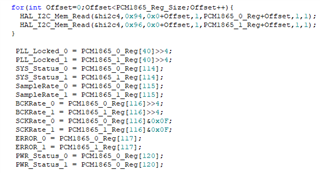

1:Data Out port shows data but measured to be a total mess with LA

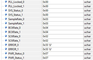

2:so that i added "# Read All Regs" to my code and get the values of Status Regs from Debugging Session,which look like
3:I found that PLL is not locked, and system status is not correct either.
4:I checked the waveform of BCLK and FS with scope, showing 12.288MHz and 48kHz, Good.
5:I also tried to provide a 12.288MHz SCK from pin15(SCKI), but things doesn't change at all.
6:I also tried to configure the clock by cancelling clock detection and manully writing Regs 0x20-0x2D, but it doesn't help.

  • Sorry for the delay. I finally found that the problem is quite simple.I pull up the I2C wires so weakly that reg values are not correctly written at a 400 kHz bit rate. After pulling up with a 4.7 kOhm Res, it works and now gets perfect audio output. Thank you quite a lot. :)
