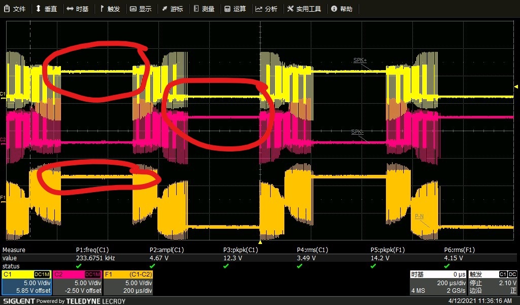

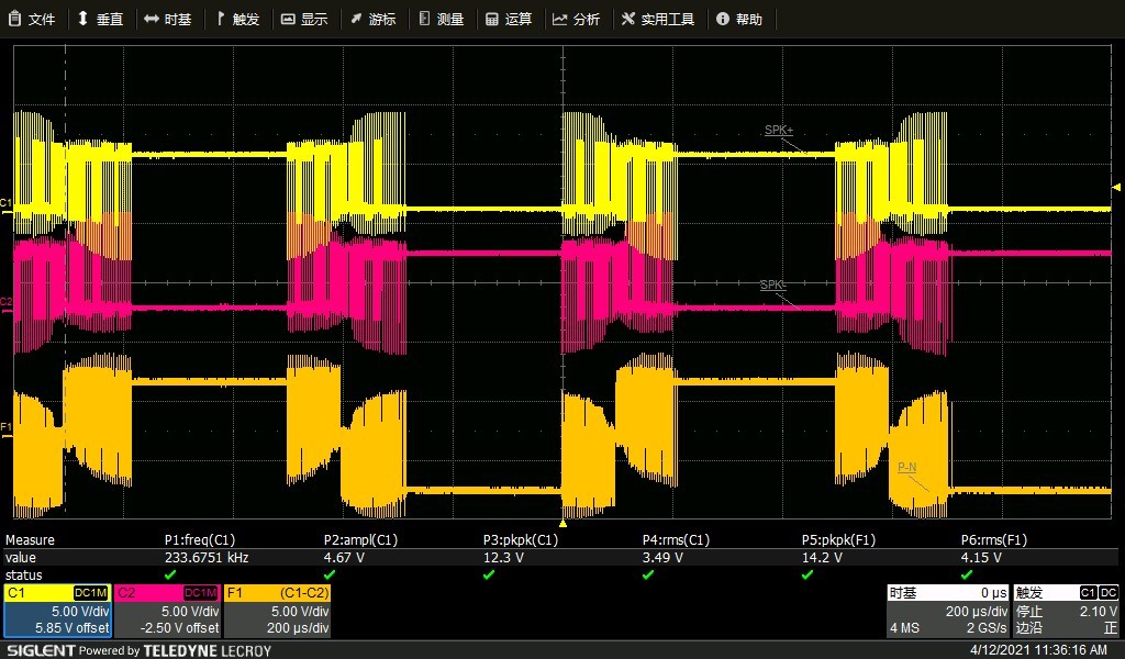

customer give 1kHz sine single to input the TAS2505, the found the output have some DC voltage ,the reamin time is about 0.3ms.
see the below, channel 1 is SPK+ ;channel 2 is SPK-; channel F is (SPK+) - (SPK-), you can see the output have a DC voltage.
1. Could you help comment why there have DC voltage? and does it will be demage speaker? the input sine is continues.

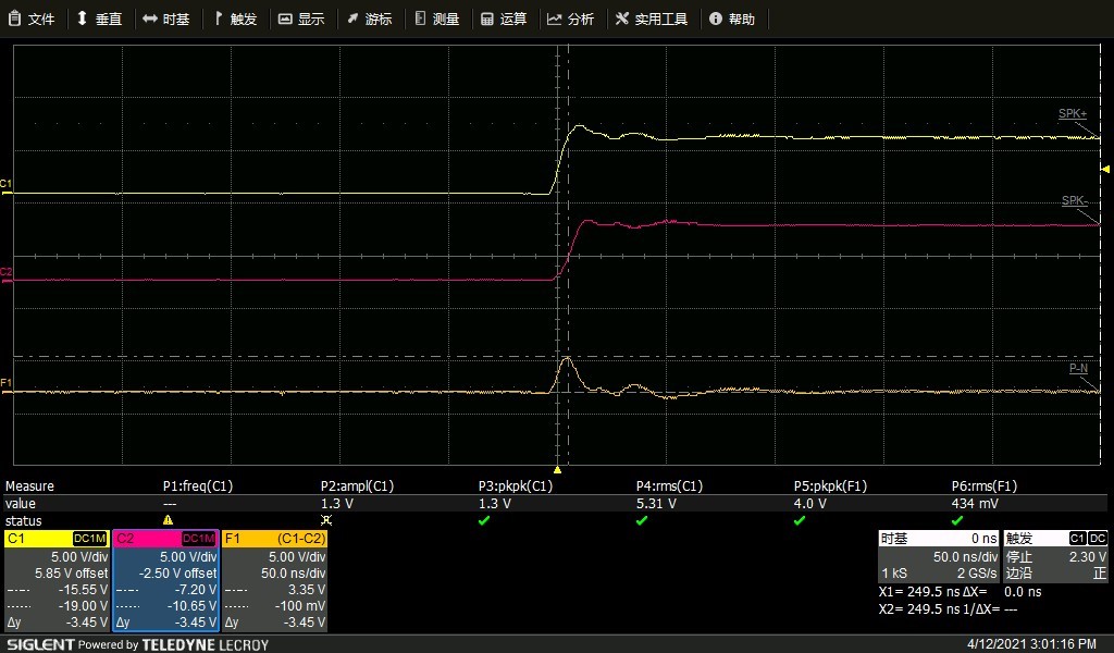

2. we also test no input signal, the output of TAS2505. found the riase time of SPK+ and SPK- is not sync, therefore, it will have a small different voltage, see the below.
The questions is does this small voltage will demage speaker? how to remove it?

    2. This offset signal is very short and should not be an issue but I will double check with my team and get back to you.

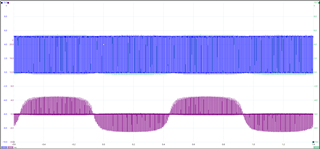

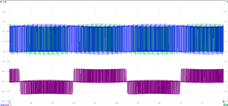

    I believe the DC voltage is simply due to the amplitude of the signal. I have attached a couple screen captures of different amplitudes below as an example.
    I am not sure that there needs to be any change here but here is some general information on DC voltage for speakers. The DC voltage can cause the speaker to heat up, but it will already be heating up with AC signals and since this DC voltage is only there for a short time, it is not a problem. Additionally, DC can sometimes add noise to the speaker so it is usually avoided.
    Max Volume:
    Lower Volume:
    As you can see, the lower voltage looks more like a sine wave.

    for question 1, you meand the DC voltage is because of max volume? below waveform is different with your attached. in the below capture, there have a consistant DC voltage I marked. we have concern that this DC will demage speaker.

    more information. customer test it with differenct volume. if the volume higher than 12db, such as 18dB, it will have DC voltage. if the volum is 12dB, the output is normal sine wave.
    can you help explain why will have this problem when it in High volume? does this have some limit in applicaiton?
    thank you.
    It seems like the DC is similar to clipping. When you play the sound at 18dB, does the speaker have any poor sound quality? I tested with a couple different speakers and only had issues with this on lower power ratings. If I remember correctly from a previous conversation, this is a 5W speaker correct? If so, I wouldn't expect any issues in sound quality due to this.
