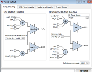

    w 30 52 00
    I have also included some images of the audacity recording as well as a scope shot of HPL/HPR to show that both recording and playback is working.
    Let me know if this script works. If it does not, I recommend trying the digital loopback test. I didn't receive confirmation if you had tried digital loopback and if not, you can go to the Digital settings section, then Clocks/Interface and click on the Audio Interface tab. You should see the following screen and here you can select Digital Loopback. this will internally route DOUT to DIN. Please make sure the script has been loaded before selecting Digital Loopback.
    Aaron Estrada
