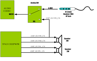

I want to find a analog switch solution to switch the MIC and PA out signal. Please see the block diagram as figure1.
I have measured the PA output signal with 4ohm/2W by scope as figure2.
Can you suggest which analog switch I can do this?
figure1
AMP_OUTPR_CN signal voltage as below
1. Peak to peak is 4V.
2. Voltage maximum is 8.16V.
3. Voltage minmum is 4.16V.
