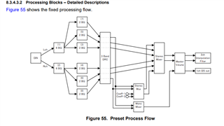

  • I looked at the driver for Linux. This setting can be changed through ALSAMIX.
    If i enable "Fixed process flow". I dont see Output.
    I need a program for "Fixed process flow".
    Where can you find sample programs for "Fixed process flow"?
    Andrew.
  • The fixed process flow is detailed in the device datasheet, but you can customize the values using PurePath Studio.  This lets you implement some BQ filters and a DRC.   Using the fixed process flow with custom DSP coefficients means that you have to write ~1000 registers to the device, so keep that in mind if you want to go this route.
    If you are trying to disable the digital filter (I am not sure why you want this), you could change the setting in register 34 to the "octal" speed setting.
