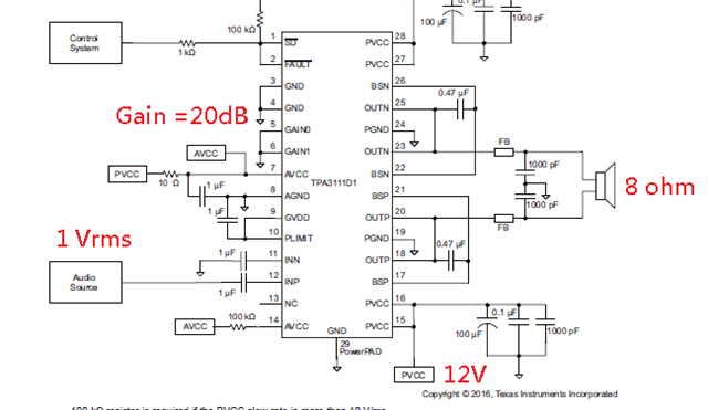

There is a good news that we design in TPA3111D1 in customer's new project.
In this condition, what is the value of output power?

Hi Denny,
As stated in your schematic, the gain is 20dB or 10V/V. With 1Vrms in, the output will be 10Vrms. With a 12V supply, one cannot get to 10Vrms without clipping. To calculate the power with losses, look at section 7.3.4 in the datasheet for the details.

Denny,
I would need more information. What voltage or power do you want at the speaker load with the 1Vrms signal?
Hi Gregg
The preliminary setting for TPA3111D1PWPR is below, due to the minimum gain setting is 20dB, so we would need an Attenuator before INP input, then fine tune it to our target power 5~8W, if the INP input is 1Vrms that output will be clipped from comments.

Hi Denny,
I created a basic circuit in TI-Tina. The attenuator you need is made of R1, R2, and R3.

Can you provide Attenuator with single-end output, we want to follow the schematic in datasheet and EVM.

Denny,
You need to use the attenuator that I proposed for a single ended source to the differential input. The input must have a balanced input impedance for the best audio performance.
