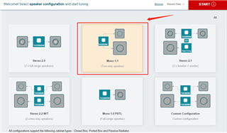

Hi all,
I'm working on a conference product with TAS5805 amplifier in mono 1.1 mode. And we're using one amp to drive a tweeter and a woofer. But we found that both tweeter and woofer will output the same mono audio. Actually, we would like to separate the mono audio source, tweeter is for treble and woofer is for bass.  Did the mono 1.1 mode can meet this requirement? And What I need to do in PPC3 software? Thanks for your support!
Here are the snapshot about the working mode I'm using.
