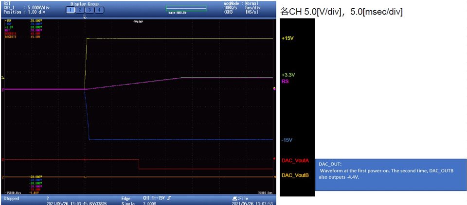

The customer's DAC will show an unintended output voltage after POR. Increasing the "time constant" of the RS Pin will solve this problem.
VDD = 5V
CS, CLK = pull up 3.3V
LDAC = Low fixed
RS: 10k / 0.01uF
The power sequence is 5V-> 3.3V, and after 5V is completely turned on, 3.3V is turned on.
In this case, CS and RS start up at the same time, but RS is slightly slower.
Changing RS to 220k ohms / 0.01uF will improve it, so it is possible that the reset was released and LDAC was enabled before CS reached 3.3V.
Because LDAC is fixed at Low.
However, CLK has only one rise during this time.
18 Bit is required for data loading.
Is DAC OUT updated with LDAC = Low even if the number of clocks is 18 bits or less? (In this case, when CS = Hi)
Also, if this phenomenon occurs without writing a value to the DAC register even once,
Is DAC OUT indefinite?

    When RS = Low, the output of I-V AMP remains 0V.
    This is the customer intended. Since it is fixed at MSB = Low (sorry, I missed mentioning "MSB" in the previous post).
    // This is R and C connected to RS.
    When the reset rise slope is slowed down, the OUTPUT of I-V AMP is 0V (normal).
    After first POR,
    / VOUTA is -4.2V
    / VOUTB is 0V
    It works for only 1 second and turns off. It will turn on again after 1 second.
    After the second POR, both VOUTA and B will be -4.2V...
    It is driven intermittently on the system for 1 second and may not turn off completely.

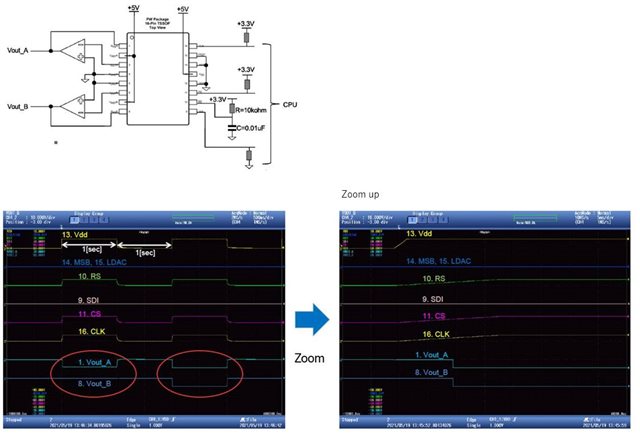

  • Hi Akhilesh K-san,
    We received the schematic and measurement results from our customer.
    They removed the RS CAP, but the result is the same.
    First turn-on: only VOUT_A shifts from 0V to -4.4V.
    Second turn-on: Both VOUT_A and B shifts from 0V to -4.4V.
    The power supply of OPAMP is +/- 15V.
    5V and 3.3V are made from a 15V power supply.
    And the 15V power supply uses an external regulated power supply, and the power on / off cycle is controlled by an external device.
    That is, the power is on / off at the board level, so the microcontroller is not running while the power is off.
     Also, the SPI is connected to a microcontroller, but no signal is input or output in this test.
    I don't understand why the situation is different between the first and second turn-ons.
    I think there is a possibility of failure due to some leak current.
     Please let me know if there is a problem with this circuit, power on / off cycle and this circuit.
    //Previous circuit (RS: 10k ohm, 0.01uF)
    * File:DAC8812 POR.xlsx
    //Change RS circuit
    I apologize for the inconvenience.
    Please give me some advice.
    Hiroshi

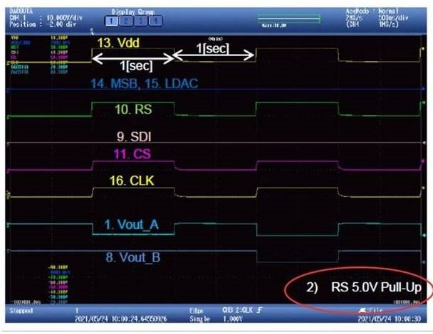

    Can I get following waveforms as well?
    +/-15V ramp, 3.3V, VOUT_A and B with RS pulled high to 3.3V
    AK
    Thank you for your support.
    Attach additional measurement results.
    I would appreciate it if you could check it.
    Hiroshi
  • Hi Hiroshi-san,
    I am concerned that this very long ramp time for the RS pin is causing the device to enter in an unexpected POR state.  Can the MCU keep these pins low until it is the fully powered? Or you can connect RS to VDD (+5V) as that seems to have a faster ramp.
    Paul

  • Hi, all,
    When RS is pulled up at 5V
    After RS starts first, CS slowly reaches 3.3V (malfunction occurs during that time)
    Therefore, I think that the cause is not the reset trouble but the operation due to the intermediate voltage of the logic level.
    The 74xxx series logic ICs have a regulation of "Δt / Δv (Input transition rise or fall rate)".
    Does the DAC8812 need this consideration?
    Please let us know what you think.
    Customers are worried that setting RS low enough time will not solve this problem.
    Hiroshi
  • I would not expect the CS line to cause this problem.  My expectation is that the lack of RS control is  causing this issue.
    Paul
  • Hi Paul,
    I asked the customer for additional research on CS Line.
    First, this is an existing circuit. Vout B works unintentionally during RS or CS ramps.
    Next, if you remove the CS pull-up, CS will start up later than the RS ramp-up. At this time, the firmware controls only VoutA.
    So VoutA is correct and VoutB is unintended output.
    From this, I think this issue depends on CS as well as RS.
    I think the only safe way is to hold RS low until CS is HI. Is this correct at the IC design level? Or TI experience is OK.

  • Hi Hiroshi-san,
    We checked the same with our design team and here is the explanation from a design point of view.
    In one of your case issue is predominantly due to taking CS high almost simultaneous to the RS reset signal.Note that the internal shift register does not have a reset function for its register, and thus can power-up at any unknown digital word state.  If a low-to-high signal is seen on CS before clocking in valid data then whatever initial data that is in the shift reg will get loaded into the DAC input reg.  Since LDAC is low, this will immediately pass to the DAC output.  However, if RS is kept low after CS goes high, it keeps the input register properly cleared.
    This is why when they increase the time constant on RS, its working OK. There is no clock counter for loading the DAC input registers.  They get loaded by the address bits set and the low-to-high transition of CS.
    AK
