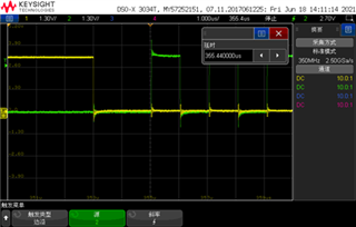

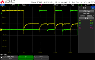

   I use a SOC to communicate with ADS1299.
   When I connect the SOC SPI lines(Din Dout CS SCLK) to ADS1299 lines, the CS signal (yellow one )seems abnormal.
I check the datasheet, the CS signal is too high to be recognized.
I disconnect the SPI lines and test the SOC's CS, I get a normal signal,
I use the ADS1299EEGFE-PDK. I don not know if there are special design for the CS signal in this development board.
Can you help me with this?

    Thanks for the information. The CSB signal behaves the same as the other digital input pins. There is no special requirement for the CSB for the device. I assume you are not sharing the CSB signals with any other devices in your test setup. From the original waveform, the CSB is pulled low on every SPI positive rising edge before rising a steady voltage of 1V. There seems to be some interference between the SPI signals and the CSB signals.
