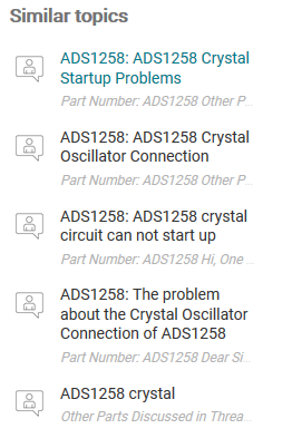

    In fact, I would not recommend using a crystal at all with the ADS1258. The 32 kHz watch crystals required by the ADS1258 can be challenging to get consistent results. If you look to the right of this post, you can see many questions related to crystal problems with the ADS1258 - I have included a screenshot below just in case you are seeing something different. Please suggest to the customer to read these posts before committing to using a crystal. If they still want to use a crystal, they can look at the current BOM of the ADS1258EVM for the crystal used with this board as a reference.
    However, I would strongly suggest they consider a discrete clock oscillator instead of a crystal. The crystal problems can result from a variety of factors, and there is no single solution that guarantees results i.e. what works for some engineers does not work for others, and vice versa.
