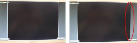

Hello Larry,
We're using THS8200 for a project. It is strange that we found the rightmost vertical line sometime disappears, but sometime appears. This symptom sometime can be recovered by disconnecting cable and then reconnecting it many times. Also, it only occurs with SD formats (D1-525(720x486) & D2-625(720x576)). I have set all register values as recommendation except 0x1C and 0x82. For our project, we need to select 20bit or 10bit mode rather than 30bit mode as recommendation. I have tried to decrease the width of front porch (0x2F: 0x14->0x10), but it still does't work. But, if I select the 30bit mode, the rightmost line always displays. So, I am wondering is there any way that I could solve this problem without setting it in 30bit mode? Btw, I have checked the digital input data and the input is correct for sure.
0x1C: 0x60(recommendation) -> 0x5C
0x82: 0x83(recommendation) -> 0xA3
Eddie
  • Eddie,
    Does the vertical line at the left border shift, when line at the right border disappears?  I am trying to deterrmine if the picture is shifting, or if the line is being cropped without shifting.
  • Hello Larry,
    I had checked the output waveform and the rightmost line did disappear. Also, I tried to shift the picture position by setting 0x7A, but it doesn't work. It is strange that I found evaluation board (TVP700X EVM REV1.0 + THS8200EVM REV2.0) has the same symptom when I set TVP700X to output 20bit 4:2:2 format and THS8200 to receive 20bit 4:2:2 format.
    It seems that the only way to solve this problem is to set THS8200 to receive 30bit input data (0x1C: 0x60) and derive embedded sync form HS, VS, and FID (0x82: 0x83). Unfortunately, our front-end IC is only able to output 10/20bit 4:2:2 format. Do you have any idea of how to solve this problem?

  • Hello Larry, Followings are my settings: Output YPbPr -> 0x82 = 0xA3 Bypass CSC -> 0x19 = 0x03 10bit 422 mode -> 0x1C = 0x5C The digital source is from a SDI deserializer IC. I attached the output waveform from the deserializer. The left pic displays with black pattern, and the right pic displays with frame pattern. You can observe that the rightmost line does appear in the output of deserializer IC.
