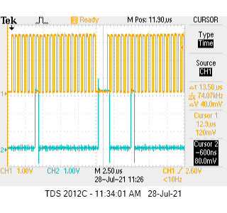

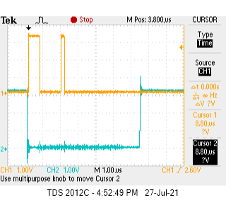

Thanks for the scope image but still CS signal missing in your capture. DAC code will update rising edge of CS signal.
Also, SYNC-EN bit must set to 0.
Please share SPI capture with CS signal and ensure SYNC-EN bit set to 0.
Dear Anbu Mani35,
Please find the Attached Graphs
Clock and CS:
MOSI and CS:
So, I am trying to read Device ID and Version. But MISO signal is disturbed.

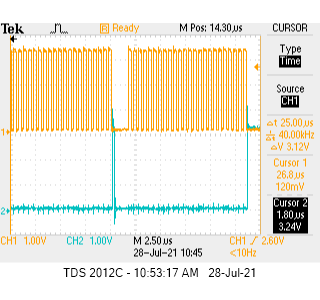

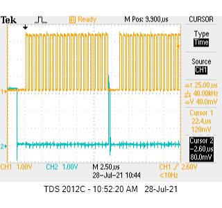

You mentioned that MISO signal get disturbed , meaning are you getting something not valid data at MISO ? your captured image not showing MISO data. could you please share(CS,CLK,SDI, SDO) on signal screen. if you are suing 2ch scope
share SPI code of read device ID, what sequence are you following ? did you enable SDO -EN bit at register 03
Read device ID required 2 SPI cycles, 1s read command(write cycle), 2nd data read (read cycle)- refer Fig7-2
Please find the attached Signals and Code
Mode configured with Polarity: 0, Phase: 1

Trying to read Device ID and Version.
CLK and CS
MOSI: CLK and Data
MISO: CLK and Data
