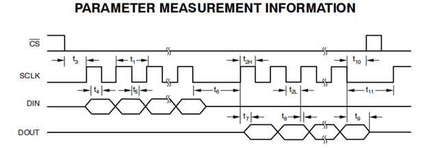

I need some help with some issues when communicating via SPI between DSP F28335 and ADS1256. The ADS1256 was not responding to any command, and MISO always return FF whenever I read register or data. I doubt it that the command sent to ADC was not recognized, so it had no response. Data Ready was connected to a GPIO, when powering up, data ready signal is with 33us period, namely around 2.4 us high, then around 30.6 us low,
The F28335 SPI SCLK is set at 1.25 MHz, with sending out data on rising edge and receiving data on falling edge, no phase delay, idle low.
I have attached the wave form showing SCLK, CS and MOSI. The timing between SCLK, CS and MOSI meets the timing specification shown below. And the consecutive MOSI bytes also meets timing requirements. The MISO was not shown, but in the test, it always stayed high.
The following figure showed when writing a single byte. Blue line -- CS, Yellow line -- SCLK, Purple line -- MOSI.
The following figure shows when writing multiple bytes. Green line -- CS, Purple line -- SCLK, Blue line -- MOSI
I have also attached the configuration code. This is ADC set up.

  • Hi Chad,
    Do you have a schematic to share?
    The DRDY signal is a good sign since this appears to be toggling at the default data rate (30kSPS). This means the ADC is working in some capacity.
    Are you toggling CS between bytes? The first image you show has CS going low at the beginning of the byte and CS going high at the end. The command you are sending appears to be 0101 0011, which is a WREG beginning at register 3 (DRATE). However, pulling CS high after this byte resets the SPI interface, so the command never gets executed. I cannot really tell what us going on in the second image with all of the different signals, but CS appears to go high after each byte. This is acceptable for some commands, but not for RREG and WREG.
    You will also need to keep CS low when clocking out data (sending the RDATA command, wait time t6, then issue 24 SCLKs).
    Let me know if changing any of this behavior improves your results.
    -Bryan
  • Hi, Bryan:
    Thank you very much for your prompt response. This helps me a lot, and I will give a try.
    I am using an ADS1256 module off-the-shelf, so I don't have a schematics to show here. I am using a DSP F28335 as the SPI master, and ADS1256 is interfacing with original 28335 SPI interface. F28335 SPI CS is connected to ADC's CS, and F28335 is sending out 8 bit each time, so that's why CS was pulled low first and then pulled high. I guess I need to use a GPIO to act as the CS line.
    Besides, I do have two follow up questions.
    1. What is the timing interval requirements between the consecutive bytes for the WREG and RREG command? Is it t11 (1/CLKIN * 4)? For instance, the interval between "0001 rrrr" and "0000 nnnn"?
    2. When sending out WREG and RREG command, do I need to wait for Data Ready to go low first?
    Chad
  • Hi Chad,
    If you have two separate boards, make sure that there is a strong, solid ground connection between them. Any variation in the ground potentials in the two boards can lead to noise and undefined communication behavior.
    To answer your questions:
    1. There is no timing delay required between bytes when sending a WREG or RREG command. This is stated in the Command Definition section on page 34 in the ADS1256 datasheet
    2. WREG and RREG can be issued at any time, you do not need to wait until DRDY goes low. However, keep in mind that if you change the ADC settings you should restart the conversion process, as the conversion in progress may get corrupted by the change in settings.
  • Hi, Bryan:
    Now I use a GPIO as the CS line, it stays low during the entire period when I send out command bytes. When I read registers, it returned values as "00". Do you have any suggestions for this issue?
    Besides, I doubt if it will be harmful for inserting some delay between consecutive bytes when sending out WREG or RREG. Since F28335 data is 16 bit width, I noticed that sometimes when I sent out consecutive bytes without delay, some SCLK waveform will collapse.
    Chad
  • Hi Chad,
    Do you have a strong ground connection between the two (or more?) boards? Since the SCLK signal is driven by the MCU, I don't know why it would be collapsing unless there is some sort of noise or voltage difference present. In other words, this would not be an issue with the ADC.
