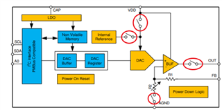

In the following figure, I can see 4 internal switches at VDD, REF, OUT and AGND.
My customer has a two questions regarding the internal switches.
1. Is it able to set the initial ON/OFF state for these switches by setting EEPROM? The Initial state means the state just after the POR. I understand the initial state of switches conncted to VDD and REF can be set by REF_EN bit at D1h. But, how about the switches at OUT and AGND?

    1. Yes, the VREF and VDD switch is based on the reference selection for the DAC. This can be set by the REF_EN bit in the GENERAL_CONFIG Register. The switch at OUT and AGND is determined by the device power down setting in the GENERAL_CONFIG Register. In high impedance power down, the switches are open. When it is powered down to 10-k, there is a 10k resistor to ground on the output pin which isn't shown in that block diagram.   The variable resistor R2 determines the reference gain setting. This is set by the DAC_SPAN bits in the GENERAL_CONFIG Register.    These can all be saved in the EEPROM
    2. After a POR the registers are loaded with the values saved in the EEPROM and the device state is valid after 30ms.

    Regarding question 2, does the DAC43401-Q1 keep the output state high-impedance until the device state is valid after POR?
    Saito
  • Hi Saito-san,
    I'd also like to double check this question with the design team. During the POR the default register values are loaded form the NVM, but I am unsure what the output state is while the registers are being loaded. Please allow a few days for their response.
    Katlynne
  • Hi Saito-san,
    I received confirmation that the DAC output state remains in hi-z mode after VDD is applied during the POR.
