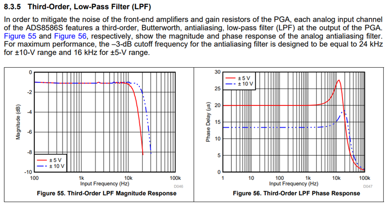

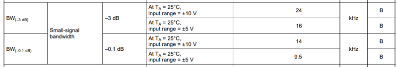

  • Hi Collin,
    So, this product has a analog bandwidth that is lower than the Nyquist bandwidth set by the sampling rates.
    I didn't quite get this point. If I am sampling at a rate of 50000 samples per second this ADC will just work fine right? And the bandwidth you said 15kHz is applicable for input signals like anything more than 15kHz will get attenuated at AFE is that correct?
    Vineeth
  • Hi Vineeth,
    No problem, the moderators will take care of the reply.  Thanks for posting back on the accidental submission.
    Yes, this ADC supports sampling rates up to 250kSPS and all channels are sampled at that rate.  Slower sampling rates, like 50kSPS, are fine as well.
    The point was that with a traditional SAR ADC without an AFE, the Nyquist bandwidth with a 50kSPS sampling rate would be 25kSPS.  In the ADS8586S device, the AFE sets the analog bandwidth as spec'ed as shown in the datasheet below:

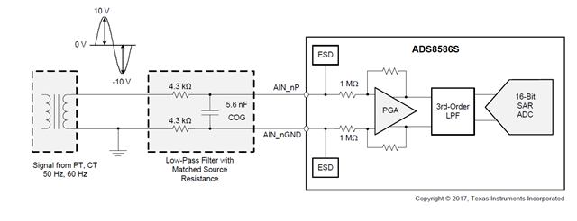

  • Hi Collin,
    Thank you for your response. Now I get it. One more thing, in application note it is shown the ADS8586 is used for CT and PT measurements.
    We have to give burden resistor between the secondary terminals right. Or can we connect it directly as shown in the figure?
    Also for using serial data transfer scheme how the clock can be generated, since it doesn't having SPI module?
    Do we have any sample codes on serial data transfer (preferable bitwise code) ?
    Vineeth
  • Hi Vineeth,
    Yes, this product is meant for multi-channel Grid applications where common inputs are CT/PT/Shunt, Rogowski Coil, etc.
    Check w/ the datasheet for the CT/PT you're using to determine the proper burden resistance and include it.  It may have been left of this diagram for simplicity.
