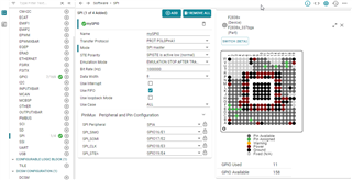

I use SysConfig to configure my pinout, in board.c I see the SPI_init and Pinmux_init:

So I am not sure what is wrong, do I need to do something else than just SPI_init()? Can you confirm GPIO_PIN_SPIA_STEN is a regular GPIO even if its defined for SPI in sysConfig?

  • Hy Bryan,thanks for helping.
    I actually found that my SPI pins were not initialized by the code generated by SysConfig, which is weird.
    So I added for CS, SIMO, SOMI and CLK with the right init and it looks OK now on the oscillo I can see the CS going low.

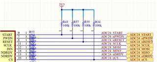

    • As I showed previously, I tied START, PWDN and RESET pin to VDD, so it means it runs directly in continuous mode.
      I try to avoid to configure any registers in the first time to make it easier. Could you confirm that with the default register values it should be enough to just monitor the DRDY and read data when DRDY goes low?
    Thank you

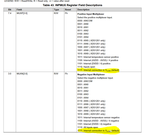

    If you leave all of the registers at their default settings, everything would be okay except for the input mux (see figure below). The mux channels default to a short to VCOM, so you would be reading 0 V (this is really how you would measure the noise of the ADC). In other words, you would not be able to read an input signal with the default settings. You could use the default settings to confirm the noise performance from the ADC datasheet, at a gain of 1, 20 SPS, and FIR filter (should be ~370nVRMS).
    -Bryan

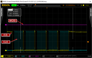

    If I probes MISO CLK and /CS I would expect to see:
    But the MOSI does not go high:
    I check the hardware by replacing the MOSI pin by a regular GPIO and I am able to toggle the pin.
    My guess is I did something wrong when I re-write the function SPI_SendReceive(DataTx, DataRx, byteLength); in interface.c:

    Also the waveform shows 5 different packets that correspond to the byteLength with no CRC so this looks good. My concern is the /CS pin, it's supposed to stay low during the whole sending, if the SPI_SendReceive function CS goes low send all the data and then CS go high...
    I am slowly getting there Grinning

    You certainly do not want to toggle CS during the data read transaction. This resets the serial interface (see section 9.5.1.1 in the datasheet). It is not clear to me where the CS is being toggled in the code, so hopefully you are able to track down this line of code and rewrite it.
    -Bryan
