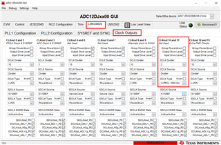

I'am currently working on a data capture system for a multiscale communications system. ADC12DJ3200EVM and TSW14J57EVM boards are more than enough for capturing desired analog signal for the project which is around 1.5-1 GHz sine-gaussian. On the other hand, I have an external circuit that needs to be clocked by ADC12DJ3200EVM. I want to use internal clocking solutions provided by ADC, there won't be any external VCO. ADC has 2 ports for DCLKOUT10P and DCLKOUT10N, J23 and J24. Assume that Fclk is selected as 3000MHz. Is it possible to get a 1.5GHz clock pulse from those ports with proper divider configuration on ADC GUI.
