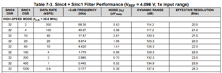

    Here is an example from the new ADS127L11 delta-sigma that has an option for a SINC4+SINC1 filter.  For the lower SINC1 OSR (number of averaged results from the SINC4), the reduction in noise is predicted by 1/sqrt(OSR), but for higher levels, the reduction is not as great, but the simple equation predicts the total noise for OSR up to 100 to within 24%.
    SINC4 filter, OSR32, Noise=7.96uVrms
    SINC4, OSR32 plus SINC1, OSR2, Noise=7.96uVrms/sqrt(2)=5.63uVrms, actual noise 5.63uVrms, 0% error
    SINC4, OSR32 plus SINC1, OSR100, Noise=7.96uVrms/sqrt(100)=0.796uVrms, actual noise 0.99uVrms, 24% error
    Regarding the use of the term ENOB in TI's older delta-sigma datasheets, the resolution term that we are specifying is effective resolution, not ENOB.  All of the above examples are effective resolution, which is a DC specification based on the internal noise of the ADC when the inputs are shorted.  This can be calculated using the following formula:

    One question about the table that shows sinc4 OSR in the first column and sinc1 OSR in the second. Is that data getting averaged, sent to a sinc4 filter and then again getting average and then sent to a sin1 filter to get the effective resolution higher. If so, that pretty cool and I do see your point of approximation. 24% error is not too shabby.
    Following up from this table, I now am wondering that if we do post process the data coming out of ADS127L01 by averaging to bring the effective resolution up, do you see the need to run it through an FIR sinc filter again? I am questioning on why the ADS127L11 used a sinc1 after the second OSR?
    Whats the advantage of breaking up the sinc filtering in stages?

  • Hi Raghu,
    Just to be clear, the SINC1 filter is equivalent to an averaging filter.  So in the above example, the SINC4 output is averaged by the SINC1, where OSR is the number of samples from the SINC4 output that are further averaged together.
    In the above table, the SINC4 filter is fixed at OSR32; it uses 32 modulator input samples to generate an output that has a data rate (internal to the ADC) of 400ksps.  The SINC1 takes the SINC4 output and further averages these values where OSR is equal to the number of output samples from the SINC4 that are averaged together.  If you take the output of the ADS127L01 low-latency filter and further average it in your host processor, you can expect to get further reduction in noise, which will result in higher effective resolution (and ENOB).
    The advantage of breaking the filters up is a tradeoff between noise and latency.  Using the ADS127L11 again as an example, setting the SINC4 to an OSR of 128 results in an output data rate of 100ksps (high-speed mode, Fclk=25.6MHz), a noise of 3.90uVrms and a latency of 40.63usec (total time for the digital filter to settle).  Using the SINC4+SINC1 option, where the SINC4 OSR is fixed at 32 and the SINC1 is set to an OSR of 4, you will get the same 100ksps data rate, but the noise has increased to 3.98uVrms and the latency is now 18.13usec.
    Keith
  • Hi Keith
    Thank you so much for pointing this out. I had to do some thinking after reading your last message and it made total sense to me. Digital averaging/moving average over a set of samples ( rectangular window in time domain) is sinc in the frequency domain. Over the weekend, I was quickly able to create a sinc filter in python and use it to average the samples coming out of my the ADC to drop my noise floor and further improve the effective resolution. Also the flexibility of using the sinc filter to eliminate 50Hz line frequency was quite satisfying to see.
