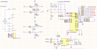

I'm developing a device that reads a load cell. Due to the characteristics of speed and precision I chose ADS1235. I developed a custom board and I'm currently at a stage where I can read data and edit registers. I don't have a lot of experience with ADC, but I am committed to learning. My question is about the best practices for performing the read value scaling and calibration adjustments.
My load cell is HBM pw15ahc3mr model. 5v excitation voltage / 2mV/V sensitivity
With this I conclude that the voltage range that the load cell will send to the ADC converter is about 20mV, correct?
Using the 128 gain I have the reading range on the ADS1235 of ±0.039 V, ±39mV, that is, the equipment will only use about 25% of the reading range of the ADS converter, is that it?
In theory, since the ADS1235 is a 24bit converter, the conversion range will be 0 - 16777215. That is, -0.039V = 0, +0.039V = 16777215. Is this idea correct?
I've read the manual several times, but I'm still not clear on how the calibration features work. Are there any more didactic material so I can learn better?
I have some standard weights to adjust the load cell readout and work with conversion calculations within the firmware. But first, at the level of the ADC converter, which settings and parameters should I pay attention to for its proper functioning?

    Im reading the inputs 4 and 5 (differential mode). My schematics is following the datasheet.
    I'm trying to scale the digital read value to weight. But when i have nothing conected in the inputs, i read a value of 1179657. When i have the load cell connected i get 1188632 with 10.8mV between pin 4 and 5(pressing the load cell, this value decreases)

    Also, your schematic shows different ground symbols for analog and digital ground. Are these all connecting back to a solid ground plane, or do you have separate ground planes for digital and analog (the latter is not recommended)?
    -Bryan
  • Hi Bryan,
    I have all ground connected in a ground plane.

    I have the inputs conected on IN4 and IN5, in differencial mode. I have a custom board, but my schematics is following the EVM reference. I have tested with DC and AC excitation, both had similar behavior on output signal resolution. Testing with load cell or with a Wheatstone Bridge made up with resistor and potentiometer had similar results also.

    Have you tried bypassing the AC excitation hardware and just putting an input directly into the ADC via AIN4 and AIN5? Do you have a precision source you can use, as opposed to a load cell or a bridge? For my tests I used a Data Precision 8200, do you have any similar benchtop equipment that allows you to apply a known, clean input voltage to the ADC?
    At this point you are just trying to determine if your PCB functions correctly. If you use the internal reference, disable the PGA, and put a 1V signal into the inputs, do you get a 1V signal out? If you can start there that would be helpful to know that at least this works. If that works, then you would test the PGA functionality by enabling the PGA, setting the gain to some value >1, and seeing if your system converts this input correctly (keep in mind the PGA common-mode limitations). If you have questions about the PGA VCM range or code conversions, you can reference our Excel-based configuration calculator for the ADS1235: https://www.ti.com/lit/zip/sbar015
    If this works, then you try an external reference via REFP0 / REFN0, and so on, until you get to a point where the system stops performing correctly. Then you can start troubleshooting. But right now you have not established any baseline performance i.e. a point at which the systems works correctly, so it's not clear when to even begin looking for issues.
