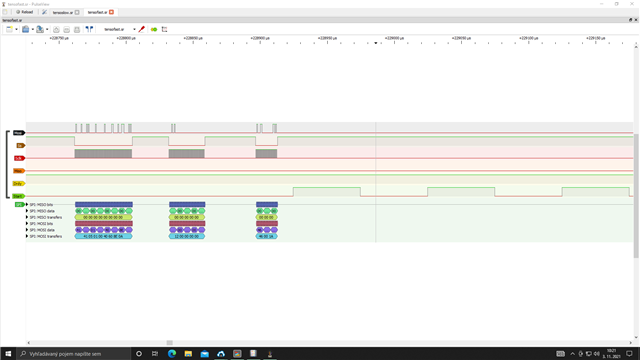

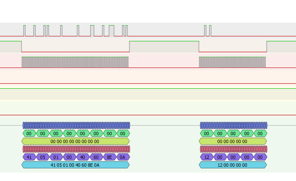

Setup sequence with fast START signal - after this nothing happens.

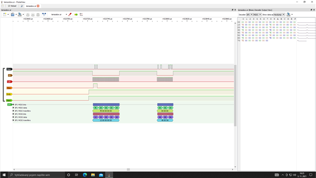

RDATA + WREG INPMUX with slow START signal. Also dump of communication at MISO line.
Setup sequence with slow START signal. Also dump of communication at MOSI line.
With slow START signal, there are continuous conversions.

  • Hi Stanislav,
    In the first sequence shown below, it looks like you are trying to read data after taking START high, which starts a new conversion - is that correct?
    In the second sequence, you write 6 registers then immediately issue an RDATA command - why?

  • Okay, so byte transmitted on MISO, while transmitting RDATA command, has changed. It was 0x7E, now 0x46. That is everything, again all zero - I have activated CRC.
    It is true that while trying to probe data lines, I did some short-circuits while device was powered. I have no suspects for MCU being damaged. However as for ADC, seems that it is damaged - what do you think?
    Stanislav

  • Hello Bryan,

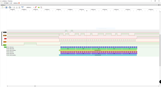

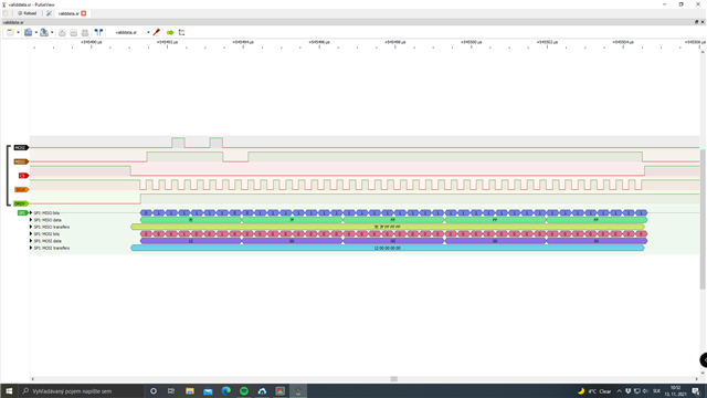

    Here are LA recordings. If I change MUX after every sample, I get zeros. Then I have removed MUX changes, unfortunately I was not able to reproduce valid results. I got 0x7FFFFFFF and some glitches on DRDY - they may be on LA probes.
    Are you willing to install Sigrok's Pulseview on your computer? Then you would be able to directly open LA recordings.
      LA.zip
    Stanislav
  • Hi Stanislav,
    SCLK is idling high in the images you just sent. This is not the correct SPI mode for the ADS1262. SCLK should idle low
    -Bryan

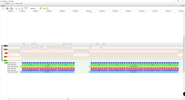

  • Hello Bryan,
    You are right. I must have switched it sometime. But unfortunately, it is only half solution.

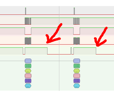

    With only single channel active, it is working. What I do not understand are short pulses on DRDY right before RDATA.
    Upon boot, first RDATA command does not have this pulse. Then it is always appearing.
    Then I add WREG INPMUX command, nothing else has changed. On RDATA command, I am getting 0x00000000.
    Data on MISO during WREG command and opcode byte of RDATA command look like they might be conversion results. Am I using incomplete RDATA sequence?
    And those additional pulses on DRDY disappear.
    Stanislav
  • Hi Stanislav,
    I would assume those short DRDY pulses are there to indicate that data is ready to be clocked out. This matches Figure 9-42 in the ADS1262 datasheet. Is there any reason you do not send the RDATA command when DRDY pulses like this? You are also not sending the RDATA command the first time DRDY drops low (see image below). You should be looking for any instance of DRDY transitioning high-to-low and then send the RDATA command. It is unclear to me how you determine when it is appropriate to send the RDATA command.
    -Bryan
