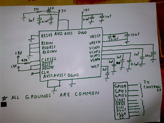

    Sir, I have created a layout of ADS12298 using external unipolar supplies of 3V or 5V (AVDD) and 1.8V (DVDD). The START pin in the schematic is not connected to a controller but can be toggled between DVDD and DGND with the help of a jumper. The pins of GPIO 2-4, /DRDY, /CS, DIN, DOUT and SCLK are to be sent to a microcontroller via a connector. I have designed my layout on Proteus and drew my schematic on a piece of paper, as Proteus doesn't have ADS1298 in a schematic. I am attaching the image of the schematic with this mail. Please, can you verify my schematic.
    Sir, I have no experience of using an SPI module. I know PIC micro to a limited extent. If you can please, send a source code on PIC to write data for suppose setting the VREF_4V bit high(just as an examle) in ADS1298 and retrieve the conversion results of the ADC. As mentioned earlier, I can change START pin high or low with the help of a jumper, so I can also send a START opcode to start ADC conversions while keeping START pin low.
    Where do I connect /DRDY in the micro?
    Can I connect a GPO pin of the micro directly to /CS pin to issue a low signal to activate SPI module of ADS1298? There can also be a voltage difference i.e 5V can be greater than 1.8V(or max DVDD 3.6V). What will I do then?
    anxiously awaiting you reply.
    Zahak
  • Hi Zahak,
    Your schematic looks ok. But, you have the analog rail tied to 3V (assuming you mean AVdd in your drawing), so setting the reference to 4V would not be applicable. As far as code is concerned, we do not have any code for a PIC microcontroller to offer. DRDY normally gets connected to an interrupt pin on the controller. If your PIC is powered from 5V, you'll need to level shift that down (the SCLK and SDI as well), then possibly level shift up the SDO and DRDY.
    Michael
