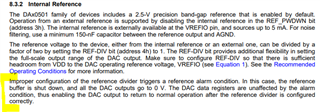

When the reference input voltage is 5V and  VDD is also 5V, Do I have to set the REF-DIV to 1(the reference voltage is internally divided by a factor of 2) and also set the BUFF-GAIN to 1(the buffer amplifier for corresponding DAC has a gain of 2.)?
I sent the following data via SPI, and input the 5V as reference voltage. But DAC did not work and output voltage was always 0V.
  • Set the Config Register to 0000_0001_0000_0000
          ->disables the device internal reference
  • Set the Gain Register to 0000_0000_0000_0000
          ->the reference voltage is unaffected
          ->the buffer amplifier for corresponding DAC has a gain of 1
What is causing this problem? Is this setting a violation? or improper configuration that triggers a reference alarm condition?
If I have to set the REF-DIV to 1 and also set the BUFF-GAIN to 1. Can I get the  following specifications.
  • the error of reference divider
  • the error of gain of the buffer amplifier (gain is 2)
  • Hi Yuichi-san,
    Yes, with a VDD of 5V, the reference input needs to be between 1.2V to 2.5V with the REF-DIV bit set to 0, or 2.4V to 5V with the REF-DIV bit set to 1:
    The reference buffer is shut down if the above conditions are not met.
    You would need to set the BUFF-GAIN bit to 1 (gain of 2) to achieve the 0 to 5V output range. The max error specs for the DAC70501 in the datasheet include the errors when the REF-DIV and BUFF-GAIN bits are set to 1. We don't have data for the individual contributions of the reference divider and buffer as we don't have a way to determine those errors independently.
