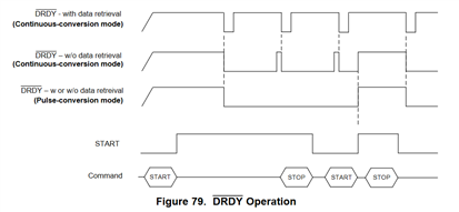

    The ADS125H02 datasheet does a pretty good job of explaining the necessary steps to start conversions, identify when a conversion is ready (DRDY goes low), how to read data (RDATA command), and how to issue commands to change registers (WREG to the mux register). Moreover, conversion latency and start conversion delay are described in sections 9.4.1.3 and 9.4.1.4 respectively.
    Do you have any specific questions about how any of these things are completed? Is there anything unclear in the ADC datasheet?
