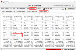

    Are you using ADC12DJ3200EVM or this is your own board? If you are using the ADC12DJ3200EVM than you will have to enable the sysref output from the LMK04828 to the ADC. You can enable the SYSREF to the ADC by going to LMK04828->Clock Outputs Tab selecting LVPECL instead of power down.
