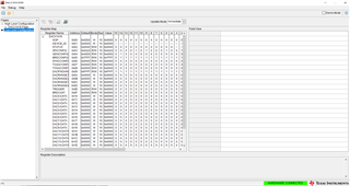

       3. In the DACX1416 tool, the registers are configured as shown below figure. But DAC output is not at all varying irrespective of any value.
Could you please share your feedback on the same?

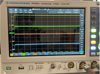

  • Hi Akhilesh,
    Please find the waveform below: Waveform is captured upon power ON.
    Even after launching GUI, no toggling is seen in the reset line. POR is not happening.
    CH1: VDD,CH2: VIO,CH3: VCC,CH4: Reset_l
    Is there any sequence for powering ON the device?
    Vidhya
  • Hi Vidhya,
    There is no power sequencing required for this device. In Channel 4, RESET high is 3.3V? I am reading the same as less than 3V
    Similarly VCC is greater than 9V?
    Can you share the screenshot of the GUI  after power up?
    AK

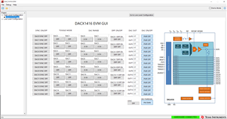

  • Hi Akhilesh,
    Below is the screenshot of the GUI after power-up.
    As per the GUI(High-level configuration file) - the device is in power-down mode.Even after enabling the power-down mode, no changes are seen.
    Vidhya
  • Hi Vidhya,
    In earlier posts, you said, GUI was not connecting to EVM. As I can see GUI is detecting the EVM correctly. Wasted too much time for debugging Slight smile
