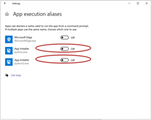

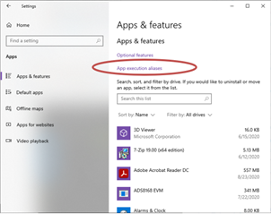

    There is a bit a trick to this in Windows 10. I would first start by unloading the newest version of python (3.10) and stick with the 2.7 version.
    Once the 2.7 version of python is downloaded and set up, you should disable the Windows App execution aliases.
    • a. Go to “Apps and Features” menu in windows (Press START button, type “Apps and Features”, press enter)
    • Select “App execution aliases”
    • Uncheck all the python values
    After that, I think it should work. Let me know if you continue to have problems.
    Joseph Wu
  • Hello Joseph,
    I changed both python values to OFF (= german Aus). After starting the GUI I get the error message " Python 2.7 not detected" again. I installed Python 2.7.18. from python.org
