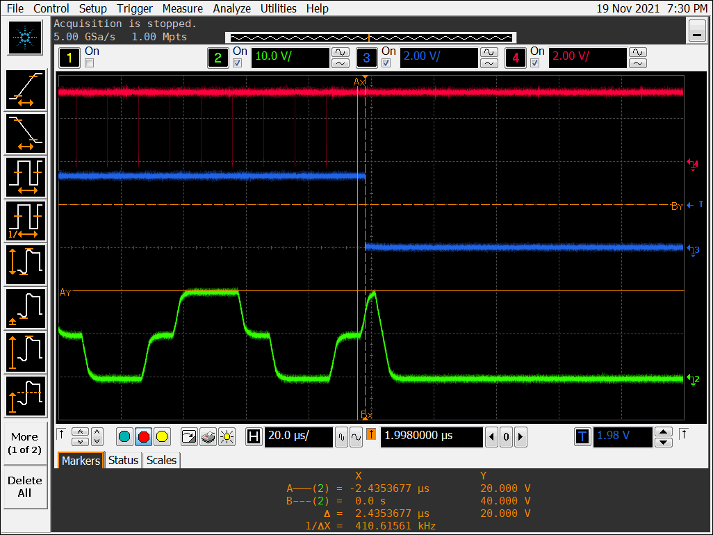

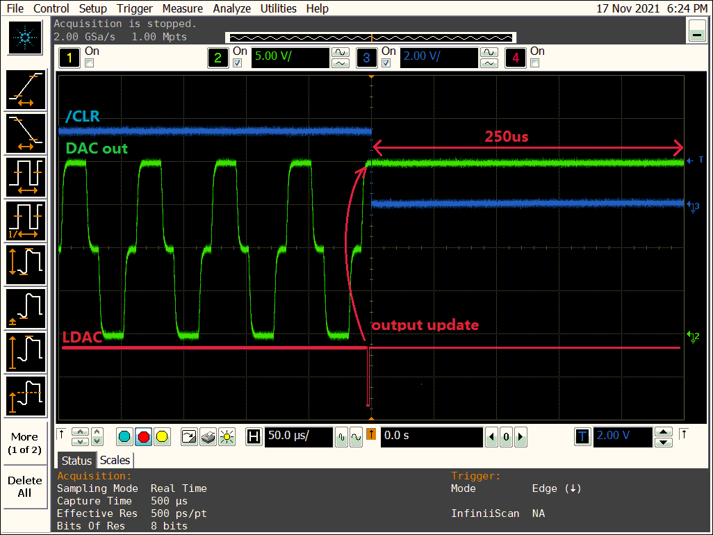

We are using DAC81416 in our design, the DAC is configured as single end mode, output range is 0~20V.
We are planing to use clear DAC function to force DAC output 0V.

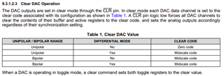

In the datasheet, the output should be forced to zero code (0V in our configuration) when /CLR pin is active, but in our design when /CLR pin acitve (low voltage), the output hold to 20V, not zero code (0V) as expected.
If there any other configuration needed to make the clear function work ?
